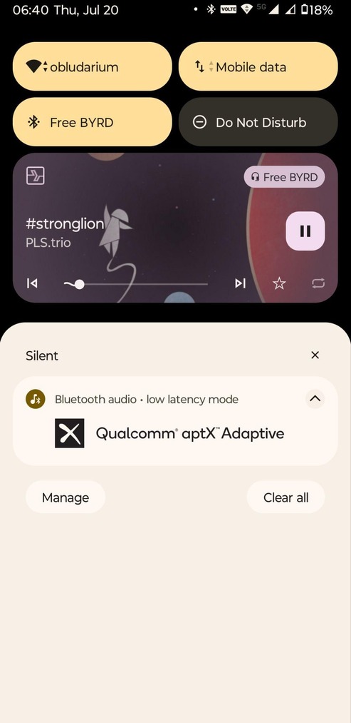

Here’s the problem: Whenever I press the power button on my phone, the music I’m playing through Plex or Plexamp pauses for about 2 seconds, and a Bluetooth notification pops up, indicating the codec currently in use. It’s honestly driving me crazy!

Thanks. Here is the screenshot of BT Silent notifications if it helps.
