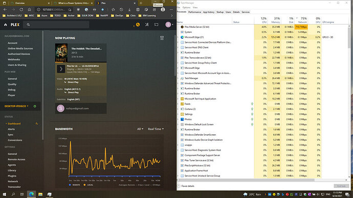

Have similar issue with Plex Server on Windows 1.23.4.4712. Using Plex player on my LG OLED55C8. If I use subtitles I suddenly see my 4K HDR content being streamed to my TV with massive throughput (not visible in Plex Dash, but in Task Manager - see attached screenshot). If I don’t use subtitles the throughput returns to normal value - 65Mbps. My library is on SMB fileshare (QNAP NAS).
