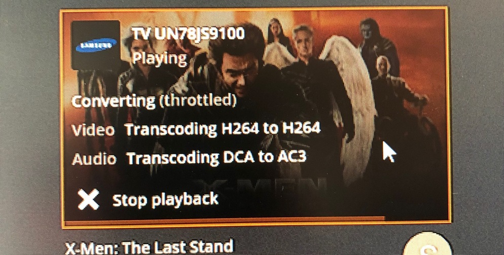

I tried to do a screenshot on my pc but wouldn’t do it somehow. But here’s the pertinent info on the screen:
Converting
Video Transcoding H264 to H264
Audio Transcoding DCA to AC3

With subtitles turned on, activity shows Transcoding. Sounds comes out of the 2 front speakers only.
