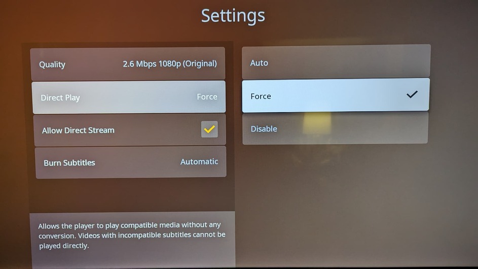

This works on an individual basis but it is annoying to have to do this for every movie I want to watch.
Thanks, my issues are when sycning/download. no issues when playing the movies to various players.
