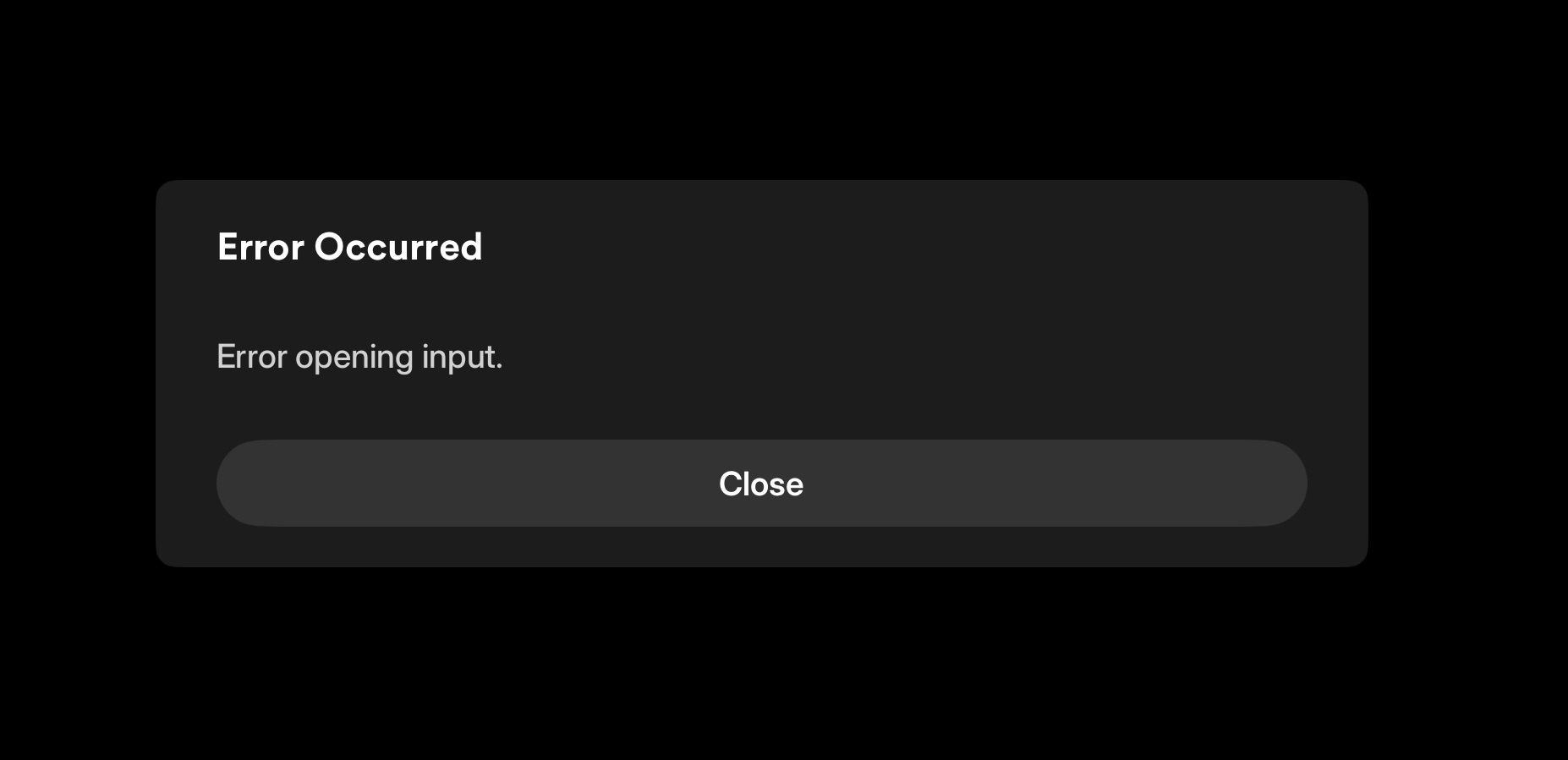

My ability to transcode seems to have disappeared. I think this worked fine a few months ago, but my typical use case is direct play, and I’ve advised all friends who use my server to direct play. Just recently, I tried downloading some media to my ipad on a lower than “original” setting and the transcode conversion process starts but stays at 0%. This worked in the past (and worked in the past with the new experience as well). I’ve tried streaming content with transcoding on as well and it fails with “Failed to open file” on both my iphone and ipad. On my desktop, it simply doesn’t do anything when I change quality to anything other than original. Playing the original works fine on all devices. I’ve done this on my local network and remotely, and see the same behavior. Transcoding just seems broken? Any thoughts on settings I should change or try? My server is on ubuntu 24.04

Appreciate the replies, I’m on Intel:
CPU: Intel(R) Xeon(R) E-2224G CPU @ 3.50GHz
GPU (integrated in cpu): Intel CoffeeLake-S GT2 [UHD Graphics P630]
HW Accelerated enabled, transcoding device set to graphics:

Sure thing @ChuckPa.
Note: I played from my iphone on the local network. My default is set to original, so I clicked play on a movie and it started playing. I went to the playback options and changed the quality to 720p or something less than original. At that point, nothing happened, and after about 15 seconds, I see the below error. If it’s easier to parse the logs with a play that immediately transcodes, let me know and I can repeat the process and update my settings so it tries to transcode. Attached are the logs.
Plex Media Server Logs_2025-08-26_15-50-55.zip (2.6 MB)

Here you can see the phone coming in and failing because the connection was too slow.

In the app quality, turn down the bitrate and retry.
Thank you for taking a look and demystifying the logs a little bit.
So I’m not entirely sure when you say turn down bitrate, that I’m doing it correctly? I’ll outline what I’ve done:
On my iphone, I went to Settings > Video & Audio > WiFi Quality, I set it to the lowest, 240p (320 Kbps). When I do this, I get the same behavior, no video will play.
I’ve tried this on my Apple TV as well, I used to be able to set the quality on any show to lower than original and it would stream fine (even though I don’t need to since it’s local and connected to the LAN not even wifi). I just tried streaming a movie on apple tv with the lowest 240p setting and it crashed the plex app entirely on AppleTV.
I’m not sure I understand why the bitrate is an issue here either? I’m able to stream over wifi the original quality shows, but when I try to reduce the bitrate, it fails, isn’t that less bandwidth?
I’ll also add:
Transcoding for downloads also does not work but it used to. When I set my download quality setting to say, “Medium”, and then I queue a show, it says “Converting (#x) 0%” and it never changes from 0%
Is there somewhere else I can look at in the logs that might shed some light? Maybe when I try to convert/transcode for a download there is another log file that I can inspect for info?
