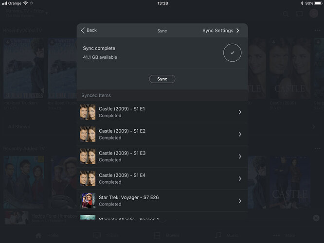

Here the screenshot of my sync at the start.

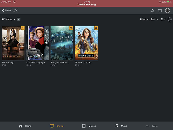

The next screenshot is the available tv shows. Note NO Castle Which was listed in the sync.

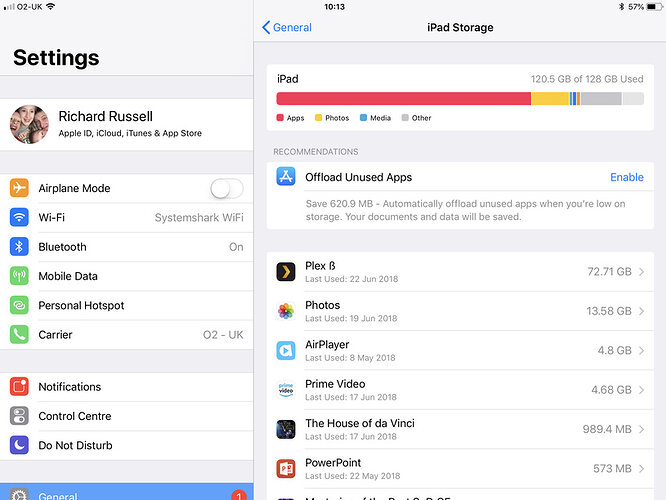

Next is my storage space on the iPad.
Sowing the usage of 72gb.

Therefore I’d LOST r40gb of space. Can we figure out why plex iOS client loses space, please?

If you look at screen shots numbers 1 it shows 4 episodes of castle are synced to the iPad.
But in screenshot 2 plex doesn’t show the episodes are available to be watched. (And I can’t find them on the device other than sync)
It something which has happened to me a few times, because I update my synced content daily. It’s means that I see episodes go missing. Aka they appear in sync but not on the tv show.

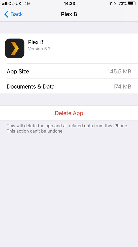

Right now I have 174Mb of Data which synced but the client can’t access it.
Finally Screen shot is the Settings->General->Storage-> showing usage.

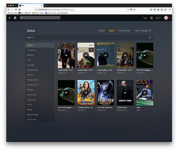

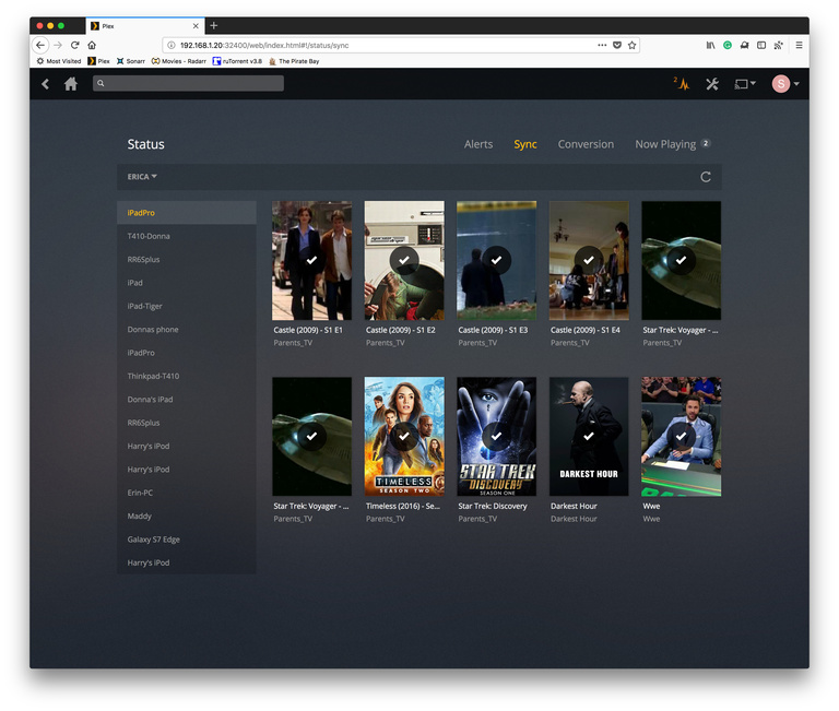

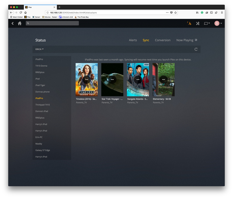

Something very strange going on. I’ve lost files from my sync, I’m playing Atlantis, but as you will on my buddyBuild post, it’s missing. however looking at the PMS service which everything is synced from my ipadpro is appearing at two different devices. Honestly, I only have Plex Beta client loaded.)
This confirms the sync view on the ipadpro, but the second view is my device which appears to have been created twice. The second via the shows, which I’m lossing… Also it’s worth noting that Timeless is on both for example, which explains where my storage space has gone.
Also I sent a PMS error as after a recent build it forced all my files to resync, perhaps this is where the abandoned client was created,
Missing Files via Server Sync view… Notice it’s saying this device hasn’t synced or been seen for a month.

Hi
The issue was because you appear to have two different instances of Plex Media Server - one you run as a service and one you run (for a short while / or accidentally ) that is outside the service.
There were two different machine identifiers for Plex Media Server Erica
I suspect you have multiple windows accounts
Could you search HKEY_USERS in the registry for aab891d690eee5689969f525025ec3f2410261ce to see where it is being picked up from. You may know already. I see you have now signed out that server instance from plex.tv but the damage was already done
Your live server that runs as a service has an id starting with 8c4a5
