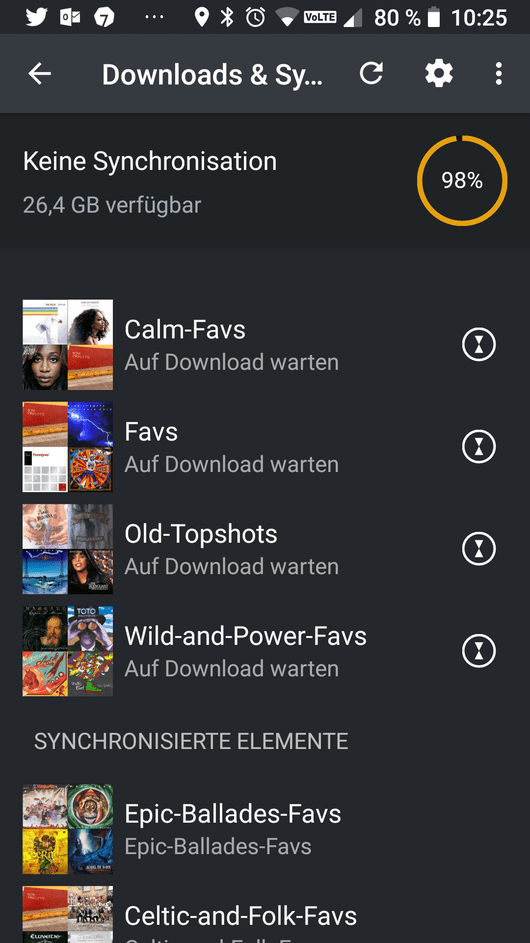

Same Problem here. I’am syncing any Playlist. Some are ok and other not as you see on the attached scr. It’s not finishing since 3 days.
