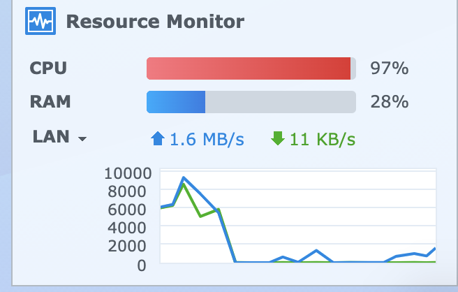

Hi, I noticed recently if I play bigger files from my Plex server hosted on my DS918+ then Syno’s CPU goes up to 90%+ and the movies start to lag. Bigger files are 720P 5-6Gbyte files which I watch in original quality.

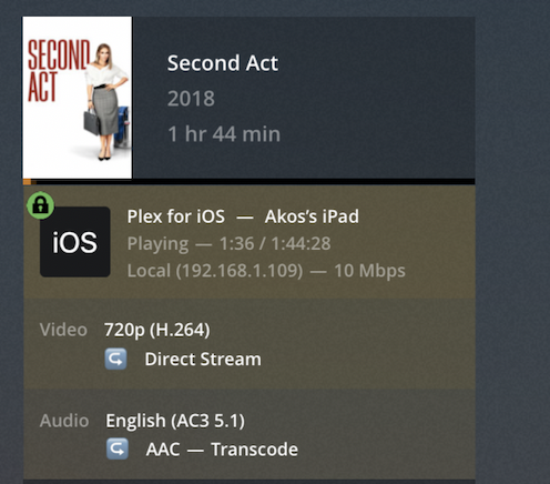

I did check the activity tab and it’s showing its playing 720p and transcoding and also the CPU is 95% as you can see it on the screenshots

FYI, Audio isn’t transcoded in hardware . Your screen capture shows video being transcoded.
