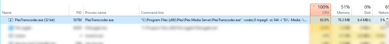

I did some testing today and in Plex’s setting on the Roku, I set it to Force a direct connection and for local connections to be Original. After doing so, I played one of the 640 x 352 (357mb) videos again then walked a room over to the server. After opening task manager, I saw PlexTranscode was using 63.9% of my CPU. The % being used did change frequently, but I assume it did as things were buffered.

Plex looks at the file and then the capabilties of the client. If the client is not capable of direct playing the file, Plex will transcode it.
https://sdkdocs.roku.com/display/sdkdoc/Video+Encoding+Guidelines#VideoEncodingGuidelines-SupportedStreamingFormats
AVI files aren’t supported on any Roku products.
Therefore plex has to step in and transcode the file or you wouldn’t be able to play them.
Your best bet is to either resource your Gilmore Girls files or us any number of tools (see my sig) that will help you convert your files to AVC video in MP4 or MKV formats. If you convert them outside of Plex then your server won’t have to do anything but serve up the files which uses hardly any cpu cycles.
