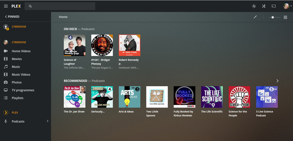

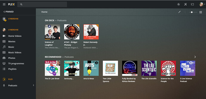

This is what I am seeing:

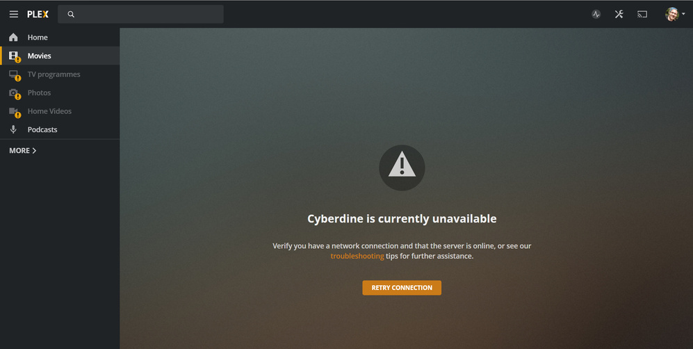

EDIT: Found the odd issue here, I have two entries for my Server and clicking MORE> reveals this:
So the question I have is, what text encoding is the Preferences.xml file should be set to? The default in Text Editor is wrong for me.
Thanks Trumpy, I managed to fix it another way but couldn’t come back to state the issue was resolved.
I only had to go in to the Authorized Devices and sort by Server, there I saw two instances for my server and deleted the one with the oldest time on it. Everything was immediately fine after that. I also found what the illegal characters were in the XML file when I was trying to save it… that was my fault too.
