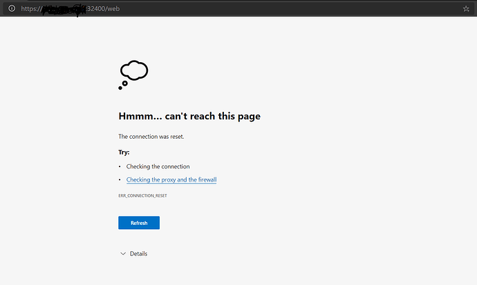

Hi, I wonder if anyone can help me solve my problem.
I can connect to my plex media server using my Synology NAS IP, Example 192.168.1.109:32400, I can connect to my server using the webpage https://app.plex.tv/ but for some odd reason i cannot connect to my server using my custom domain name. Example - https://mycustomdomain.co.uk:32400/web.
Please see attached screenshot.
When clicking the link in the screenshot it opens in a web browser but says the web address and then says refused to connect.
I have a static IP in place and can connect to my Synology NAS using my own domain which includes other applications such as Synology drive.
For the benefit of this i have set up custom port within plex to be 32400 and port forwarded the relevant ports. 192.168.1.109 > Internal port: 32400 > External port: 32400
Has anyone got any thoughts on what could be causing this problem?
Thank you in advance for any help.

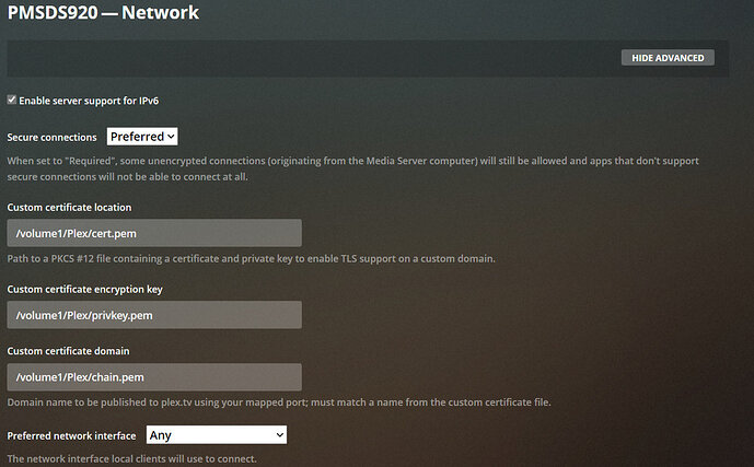

Did you add your custom domain to PMS?
Plex uses HTTPS and its own certificate for that HTTPS. If it detects another unknown certificate trying to interject, it will refuse the HTTPS connection.
Settings - Server - Network - Show Advanced
will show you the fields to fill in for your domain.
A good place to place the certificate file, where it will do no harm, is at the top of the “Plex” share (/volume1/Plex) if you don’t know where it’s installed in DSM now.

Hi Chuckpa,
Thank you so much for your help.
My Synology NAS uses Lets encrypt certificate is it this that i export and place in (/volume1/Plex)?
Forgive me for my lack of knowledge in both this areas, i am new to plex and Synology NAS.
Thank you again for any help in advance.
That’s pretty much correct except I would put your file above “Library”.
Everything in “Library” is for us to use
I am not happy with anything else in the Plex share but if you keep it at /volume1/Plex/your-certificate.pem, that would be ok and non-interfering.
Thank you for your help. I can confirm that i now access to my plex library via mydomain.co.uk:32400/web. The only problem is that it is still showing as not secure? Should it be?
& when i try to access my domain via https://mydomain.co.uk:32400/web it says connection was reset.

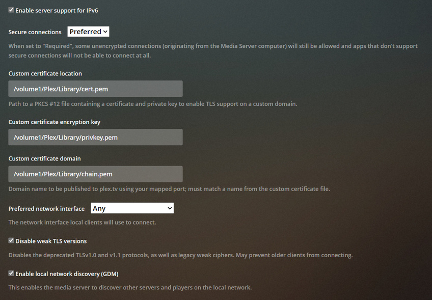

As you have advised, i have changed the location of the certificates.
Download and attach the logs ZIP please.
Let me see what PMS is doing with your new certificate.
It’s behaving as if the new domain is not being accepted.
Okay, thank you for taking the time to look. Please see attached logs. Plex Media Server Logs_2020-08-26_15-31-54.zip (1.5 MB)
Hopefully this means something to you.
There appears to be an error in the certificate.

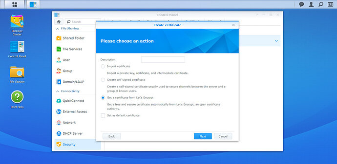

Im afraid it doesnt. I got the certificate from Lets encrypt via DSM settings, Security > certificate.
& then i exported the certificate to use with PMS?
The exported certificate gave me three files which are
Its these files ive used with plex media server? Should i be using this certificate or should i be getting one from somewhere else?

I think you need to generate a pfx file from your certificates.
I have a custom domain set up on my syno.
Will see if I can dig up my code for generating the pfx file a bit later.
This is what I use to generate mine:
Login via ssh, then run this: (you will have to enter your admin password as it is running sudo
sudo openssl pkcs12 -export -out /volume1/Plex/plexnas.pfx \
    -inkey /path/to/your/privkey.pem \
    -in /path/to/your/cert.pem \
    -certfile /path/to/your/chain.pem
you will need to change /path/to/your to where your exported certificates are
It will ask you for a password for the pfx, add one and this is what you will need to put in Plex.
so your settings in Plex would then look something like this:
(and no that’s not my real encryption key)
