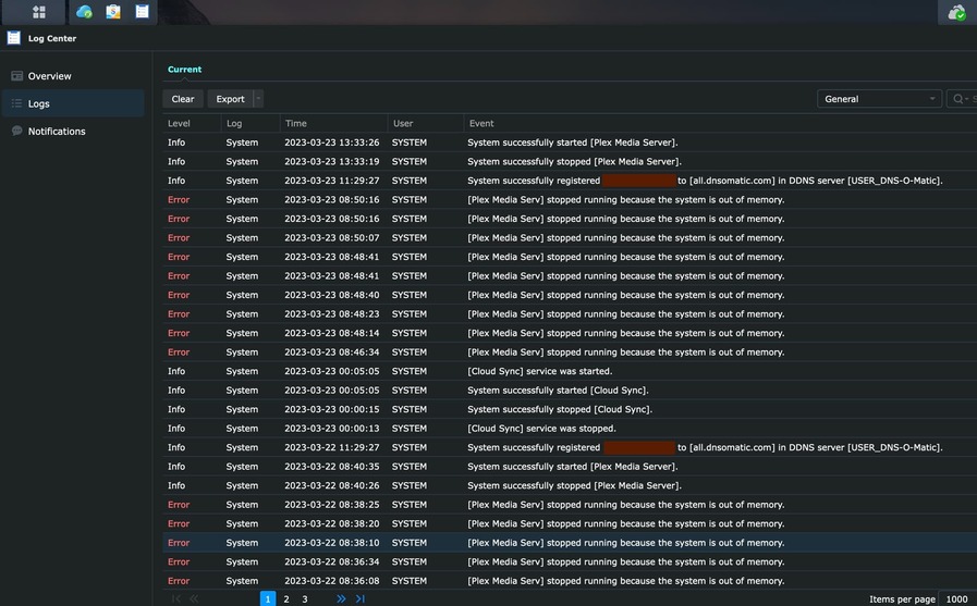

I’m getting an daily error on Synology
“SYSTEM: [Plex Media Serv] stopped running because the system is out of memory”
This has been happening for ~2 weeks, andI have:
  • upgraded Plex Server
  • Restarted Synology multiple times
Synology ‘Log Center’ show nothing else causing issues.
Has anyone seen this before?

Log Section 1:
[1804995.870926] Out of memory: Kill process 14391 (Plex Media Serv) score 655 or sacrifice child
[1804995.880574] Killed process 16917 (Plex Tuner Serv) total-vm:22672kB, anon-rss:256kB, file-rss:0kB
[1804996.059449] syno-cloud-sync invoked oom-killer: gfp_mask=0x2420848, order=0, oom_score_adj=0
[1804996.074957] CPU: 0 PID: 29476 Comm: syno-cloud-sync Tainted: P           O    4.4.180+ #42962
[1804996.084674] Hardware name: Synology DS418play/DS418play, BIOS M.319 11/11/2019
[1804996.092931]  0000000000000000 ffff8801c356f818 ffffffff812f2dbd ffff8801768444c0
[1804996.101397]  0000000000000000 ffff8801c356f850 ffffffff81185e4b ffff8801c356f980
[1804996.109865]  0000000000000000 ffff8801768444c0 ffffffff81724fc3 000000000000028f
[1804996.118333] Call Trace:
[1804996.121260]  [<ffffffff812f2dbd>] dump_stack+0x4d/0x70
[1804996.127194]  [<ffffffff81185e4b>] dump_header.isra.13+0x4b/0x164
[1804996.134098]  [<ffffffff81185f79>] oom_kill_process.cold.19+0x15/0x35d
[1804996.141487]  [<ffffffff81134660>] out_of_memory+0xf0/0x2c0
[1804996.147804]  [<ffffffff81138da8>] __alloc_pages_nodemask+0x928/0xb50
[1804996.155094]  [<ffffffff81130229>] ? find_get_entry.part.44+0x19/0x90
[1804996.162377]  [<ffffffff81130fc4>] pagecache_get_page+0x94/0x1c0
[1804996.169184]  [<ffffffff811cb57c>] __getblk_slow+0xcc/0x240
[1804996.175503]  [<ffffffff811cb72d>] __getblk_gfp+0x3d/0x50
[1804996.181626]  [<ffffffff8121d666>] __ext4_get_inode_loc+0xf6/0x3f0
[1804996.188619]  [<ffffffff8121fcbd>] ext4_iget+0x6d/0xd80
[1804996.194549]  [<ffffffff811a0045>] ? path_openat+0xc75/0x1bd0
[1804996.201049]  [<ffffffff812209fa>] ext4_iget_normal+0x2a/0x30
[1804996.207546]  [<ffffffff8122c49f>] ext4_lookup+0x18f/0x230
[1804996.213763]  [<ffffffff81198450>] lookup_real+0x20/0x60
[1804996.219785]  [<ffffffff8119877f>] __lookup_hash+0x2f/0x40
[1804996.226003]  [<ffffffff8119b8c3>] walk_component+0x243/0x350
[1804996.232516]  [<ffffffff8119c834>] path_lookupat.isra.41+0xb4/0x230
[1804996.239597]  [<ffffffff811a20aa>] filename_lookup.part.57+0x8a/0xf0
[1804996.246784]  [<ffffffff8114df44>] ? __inc_zone_page_state+0x24/0x30
[1804996.253967]  [<ffffffff81167fbe>] ? page_add_file_rmap+0x4e/0x60
[1804996.260866]  [<ffffffff811a1de3>] ? getname_flags+0x53/0x190
[1804996.267376]  [<ffffffff811a21db>] user_path_at_empty+0x3b/0x50
[1804996.274082]  [<ffffffff81193891>] vfs_fstatat+0x51/0xa0
[1804996.280108]  [<ffffffff81193a0a>] SYSC_newstat+0x3a/0x60
[1804996.286222]  [<ffffffff8103f1c0>] ? __do_page_fault+0x190/0x3f0
[1804996.293023]  [<ffffffff81194159>] SyS_newstat+0x9/0x10
[1804996.298951]  [<ffffffff8157f08a>] entry_SYSCALL_64_fastpath+0x1e/0x8e
[1804996.306459] Mem-Info:
[1804996.309225] active_anon:777083 inactive_anon:264564 isolated_anon:29
[1804996.348559] DMA free:15796kB min:172kB low:212kB high:252kB active_anon:0kB inactive_anon:0kB active_file:0kB inactive_file:0kB unevictable:0kB isolated(anon):0kB isolated(file):0kB present:15888kB managed:15796kB mlocked:0kB dirty:0kB writeback:0kB mapped:0kB shmem:0kB slab_reclaimable:0kB slab_unreclaimable:0kB kernel_stack:0kB pagetables:0kB unstable:0kB bounce:0kB free_pcp:0kB local_pcp:0kB free_cma:0kB writeback_tmp:0kB pages_scanned:0 all_unreclaimable? yes
[1804996.394572] lowmem_reserve[]: 0 1777 5764 5764
[1804996.399782] DMA32 free:36136kB min:20204kB low:25252kB high:30300kB active_anon:954776kB inactive_anon:357836kB active_file:296kB inactive_file:332kB unevictable:35360kB isolated(anon):0kB isolated(file):148kB present:1901328kB managed:1826744kB mlocked:35360kB dirty:0kB writeback:8kB mapped:23916kB shmem:2480kB slab_reclaimable:39772kB slab_unreclaimable:44444kB kernel_stack:11920kB pagetables:49028kB unstable:0kB bounce:0kB free_pcp:120kB local_pcp:0kB free_cma:0kB writeback_tmp:0kB pages_scanned:0 all_unreclaimable? no
[1804996.451609] lowmem_reserve[]: 0 0 3986 3986
[1804996.456519] Normal free:49176kB min:45156kB low:56444kB high:67732kB active_anon:2153556kB inactive_anon:700420kB active_file:2448kB inactive_file:2660kB unevictable:65808kB isolated(anon):116kB isolated(file):260kB present:4194304kB managed:4082532kB mlocked:65808kB dirty:0kB writeback:4kB mapped:58284kB shmem:10276kB slab_reclaimable:91384kB slab_unreclaimable:95564kB kernel_stack:23088kB pagetables:103824kB unstable:0kB bounce:0kB free_pcp:120kB local_pcp:0kB free_cma:0kB writeback_tmp:0kB pages_scanned:2588 all_unreclaimable? no
[1804996.509421] lowmem_reserve[]: 0 0 0 0
[1804996.513718] DMA: 3*4kB (U) 3*8kB (U) 1*16kB (U) 2*32kB (U) 3*64kB (U) 1*128kB (U) 0*256kB 0*512kB 1*1024kB (U) 1*2048kB (U) 3*4096kB (M) = 15796kB
[1804996.528761] DMA32: 187*4kB (UME) 1818*8kB (UME) 1294*16kB (UM) 6*32kB (M) 0*64kB 0*128kB 0*256kB 0*512kB 0*1024kB 0*2048kB 0*4096kB = 36188kB
[1804996.543231] Normal: 3137*4kB (UME) 3077*8kB (UME) 500*16kB (UME) 4*32kB (EH) 3*64kB (H) 1*128kB (H) 2*256kB (H) 0*512kB 1*1024kB (H) 1*2048kB (H) 0*4096kB = 49196kB
[1804996.559932] 28511 total pagecache pages
[1804996.564407] 6004 pages in swap cache
[1804996.568593] Swap cache stats: add 28080317, delete 28074304, find 111117268/114623609
[1804996.577536] Free swap  = 0kB
[1804996.580946] Total swap = 5652404kB
[1804996.584934] 1527880 pages RAM
[1804996.588437] 0 pages HighMem/MovableOnly
[1804996.592910] 46612 pages reserved

Things stand out.
  1. The total number of pages reserved
  2. The tuner service gobbling up memory
Do you have the version prior to this (SPK file) available?
EITHER —
  1. Disable / Stop “Synology Cloud Sync”
    -or-
  2. Change PMS version (less likely to remedy the issue)
If you opt to change Plex
  1. Uninstall this version with KEEP option
  2. Install the previous version
  3. give it a chance to settle (as it downgrades the database)
Continue to monitor.
This is very unusual. I’ve not seen the tuner service do this.
I’m also very suspicious of the Synology Cloud Sync app starting up.
It’s what forces PMS to terminate (your log excerpts show this)
We’ve had several reports of problems with it this past week. Definitely a bug or two in it.

Here’s a dump of the full log from that time period:
There were no logs ~45 mins before, or after that except.
(Will delete the log URL once you view, in case of anything sensitive)

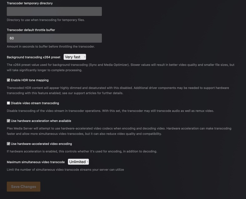

Looking through your logs, I don’t see where ‘use hardware acceleration when available’ is checked in Settings - Server - Transcoder.
Mar 23, 2023 22:17:29.982 [0x7efd3a179b38] DEBUG - [Req#b7/Transcode] [Universal] Using local file path instead of URL: /volume1/MEDIA/TV Shows/Ted Lasso/Season 03/ted.lasso.s03e01.1080p.web.h264-ggwp.mkv
Mar 23, 2023 22:17:29.982 [0x7efd3a179b38] DEBUG - [Req#b7/Transcode] TPU: hardware transcoding: final decoder: , final encoder:
Mar 23, 2023 22:17:29.984 [0x7efd3a179b38] DEBUG - [Req#b7/Transcode/JobRunner] Job running: EAE_ROOT=/var/packages/PlexMediaServer/shares/PlexMediaServer/AppData/tmp/pms-7f3e72bf-2af5-40c8-b00b-a3f26e8c07cb/EasyAudioEncoder FFMPEG_EXTERNAL_LIBS='/var/packages/PlexMediaServer/shares/PlexMediaServer/AppData/Plex\ Media\ Server/Codecs/2584b51-4483-linux-x86_64/' X_PLEX_TOKEN=xxxxxxxxxxxxxxxxxxxx4fe1-b69f-82e5b18fe169 "/volume1/@appstore/PlexMediaServer/Plex Transcoder" -codec:0 h264 -codec:1 eac3_eae -eae_prefix:1 wxdb0ft1cgxjzdpq3xv657ho_ -noaccurate_seek -analyzeduration 20000000 -probesize 20000000 -i "/volume1/MEDIA/TV Shows/Ted Lasso/Season 03/ted.lasso.s03e01.1080p.web.h264-ggwp.mkv" -map 0:0 -metadata:s:0 language=eng -codec:0 copy -filter_complex "[0:1] aresample=async=1:ochl='stereo':rematrix_maxval=0.000000dB:osr=48000[0]" -map "[0]" -metadata:s:1 language=eng -codec:1 aac -b:1 256k -f dash -seg_duration 5 -dash_segment_type mp4 -init_seg_name 'init-stream$RepresentationID$.m4s' -media_seg_name 'chunk-stream$RepresentationID$-$Number%05d$.m4s' -window_size 5 -delete_removed false -skip_to_segment 1 -time_delta 0.0625 -manifest_name "http://127.0.0.1:32400/video/:/transcode/session/wxdb0ft1cgxjzdpq3xv657ho/b4c47c47-34d1-4af5-8f96-5c75e9181982/manifest?X-Plex-Http-Pipeline=infinite" -avoid_negative_ts disabled -map_metadata -1 -map_chapters -1 dash -start_at_zero -copyts -vsync cfr -y -nostats -loglevel quiet -loglevel_plex error -progressurl http://127.0.0.1:32400/video/:/transcode/session/wxdb0ft1cgxjzdpq3xv657ho/b4c47c47-34d1-4af5-8f96-5c75e9181982/progress
It’s trying to transcode without hardware assist.
This NAS can’t transcode UHD HDR but it can to 4K SDR and all 1080p content.
@ChuckPa That’s odd, as Hardware Transcoding is enabled:

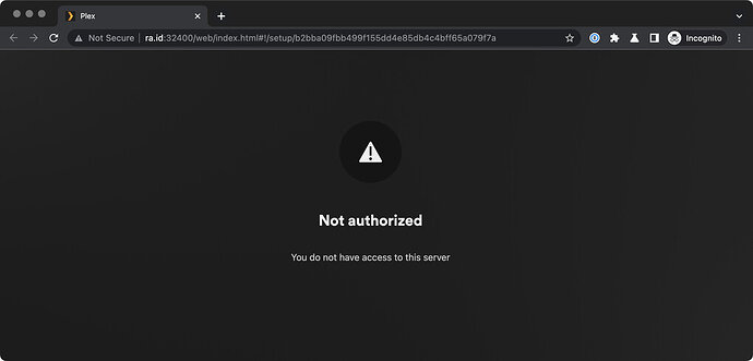

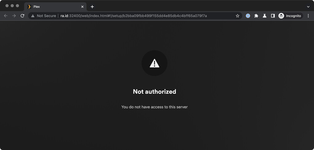

@ChuckPa followed your steps, but once I sign in after the new AppData folder is created, I get the following screen:
Any ideas?
