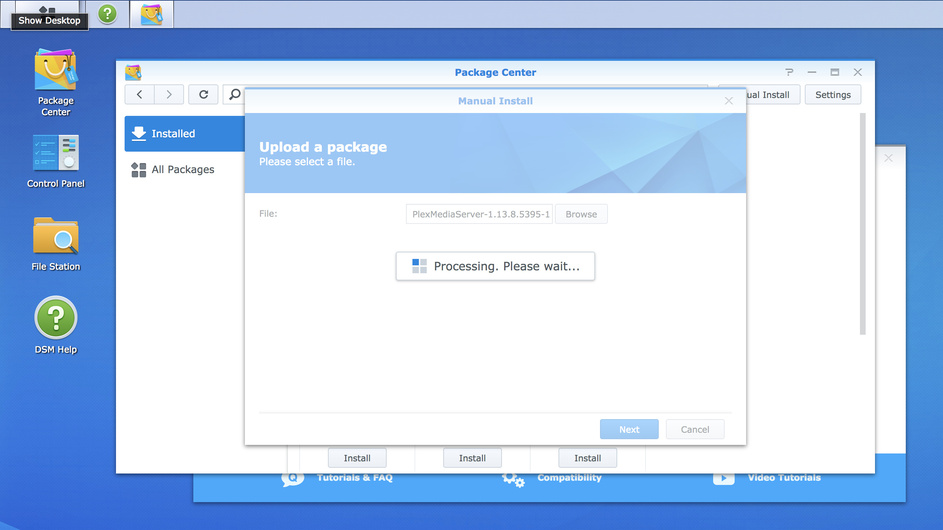

Hi all, I have been attempting to upgrade my Plex.

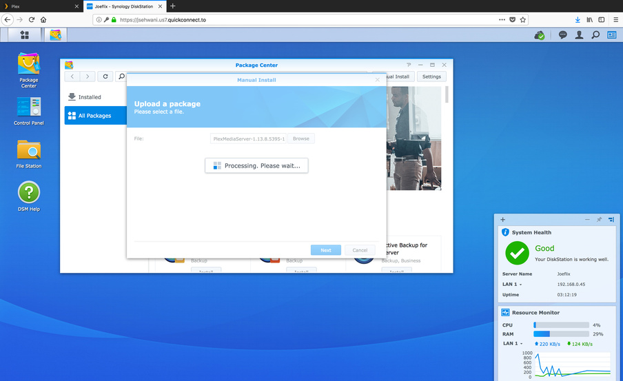

However, my DS718+ keeps getting stuck on this screen.
Please see below.
Any ideas on what to do?

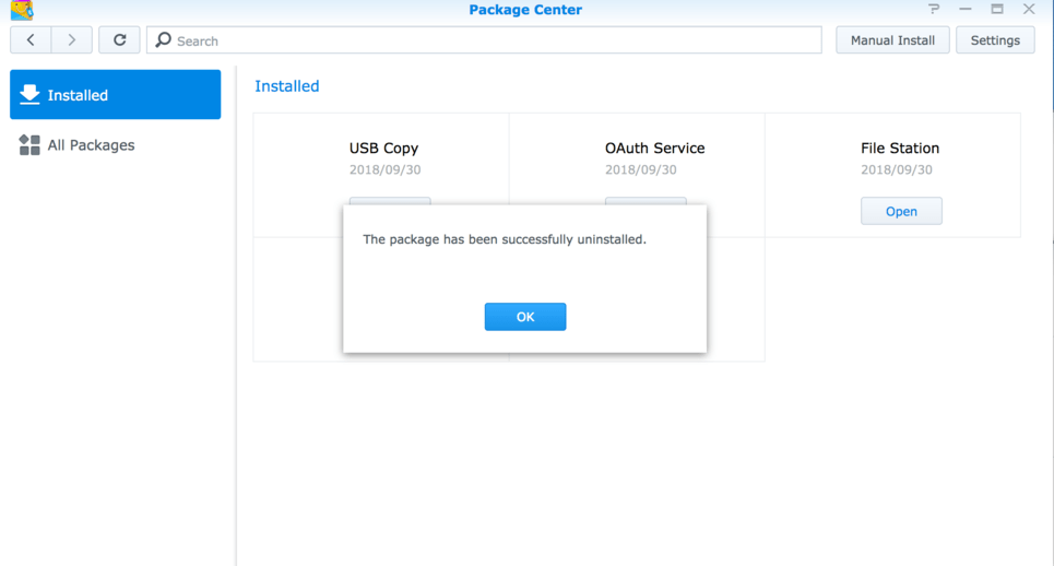

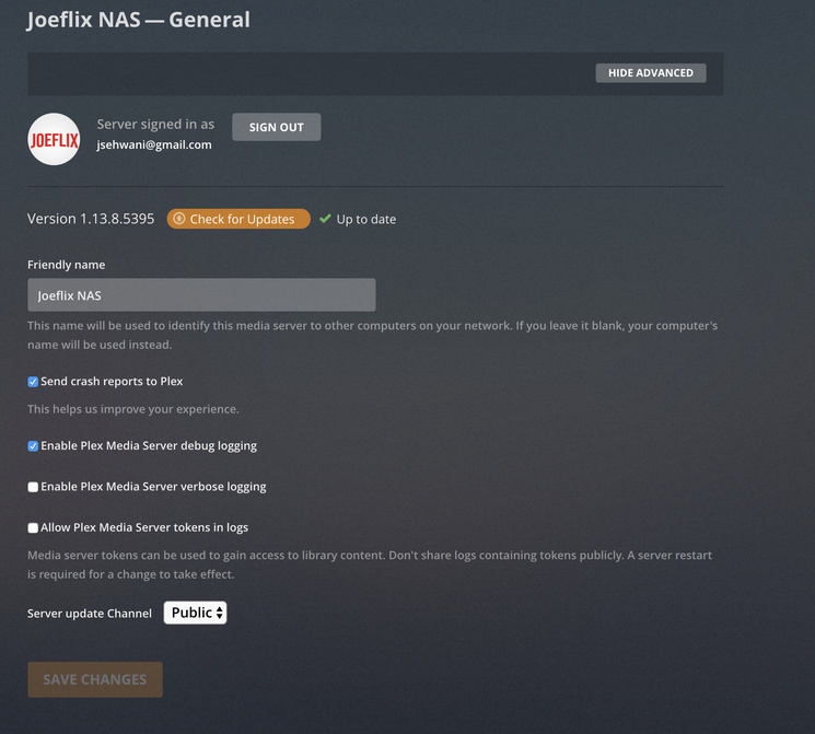

So I performed Q7 (uninstall and reinstall Plex)
And it says I am updated?
See below.
However, on the Plex Web, it still is pushing an update to me.

Open Package Center → Installed → Plex → Action → ‘Stop’.
Open Package Center → Installed → Plex → Action → ‘Uninstall’.

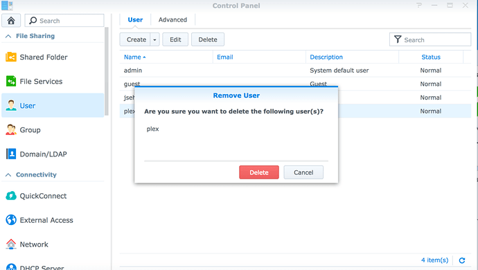

Open Control Panel → Users → Delete the Plex user.
I deleted the Plex User.

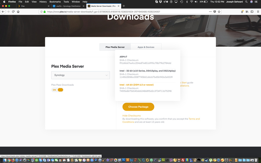

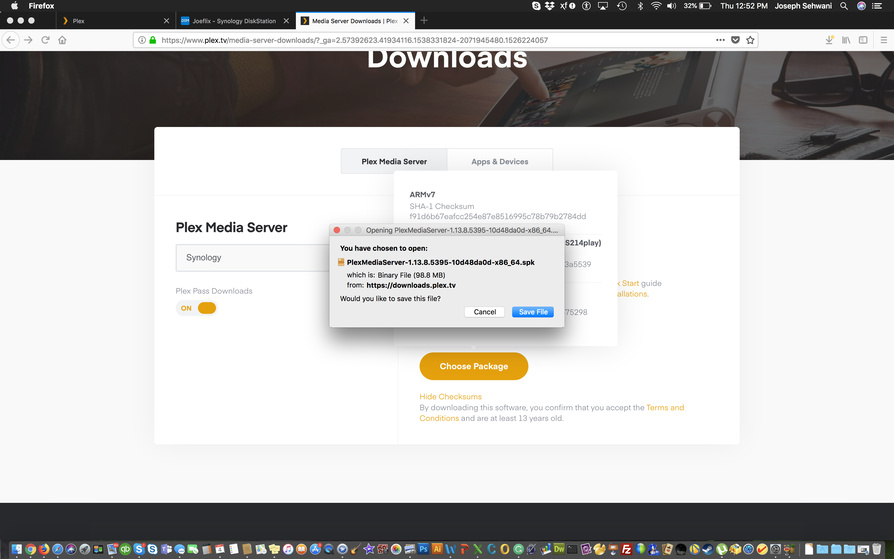

On FireFox I downloaded the SPK and made sure it was 64 bit.
I noticed it states I need version 6.0+ I screenshotted my Info Center to show I have the right version.

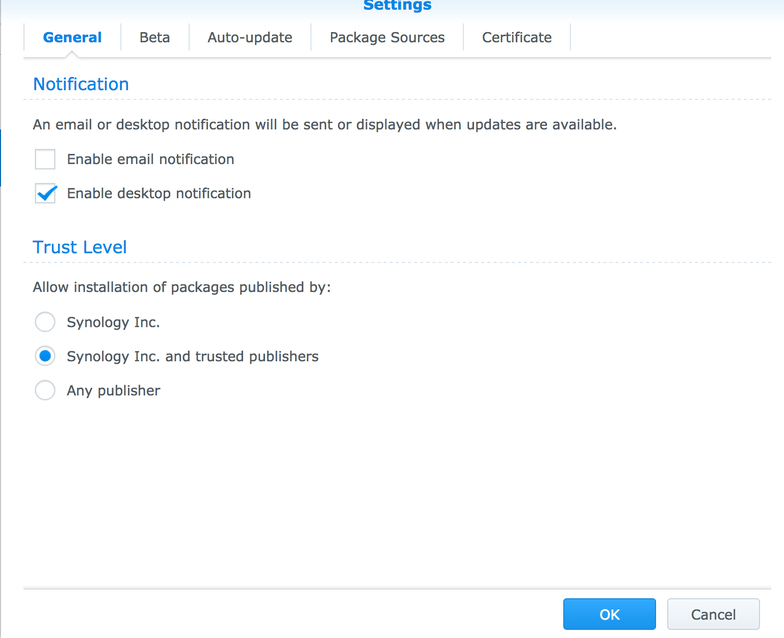

ensured Trust Level is “Synology and Trusted Publishers.”
Also, made sure to have the Plex Key in the Certificates.
Now, I upload the package, and it just hangs at “Processing. Please, wait…”
So, where am I misunderstanding or what additional details can I provide to help clear this up.

Yes, I did it is the 64-bit version.

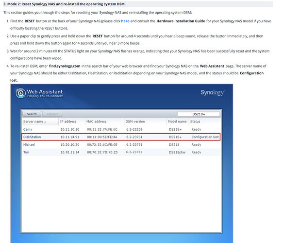

Do you think it is possible that I need to delete the Plex Media Folder to ensure everything is cleared as mentioned FAQ?
For others this is the screenshot of how to reset.

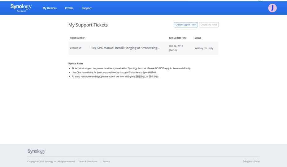

I added up creating a support ticket on Synology, I figured they can provide some more insight.
Just to let you know, it was not a DSM Reset issue. It was a Plex Cache and Folder Permission Issue.
The Synology person had me grant Read/Write permission to main users on my DS718+ and delete the Plex Cache Folder.
They also recommended I run the SPK on the same wireless as my DS718+. Since I am a Mac user they told me to run the SPK on Safari because “Have you attempted to perform the installation in different web browsers? In some cases, some process in one particular web browser may hang and prevent the upload from completing properly. Try performing the installation in different web browsers to see if the same behavior occurs there as well. If the problem happens in one browser but not others, this would point to a browser-specific issue rather than a problem with the NAS itself.”

If PMS not installing, as shown in the image above, it has nothing to do with the Plex share. It is a DSM problem. It will require DSM to be reset (Save configuration, Re-install DSM, re-install apps) which does not erase your data. Your data is safe.

After a lot of trial-error I contacted Synology who advised me to clear the Cache Folder, ensure I was on the same WiFi connection, and to use Safari.
It worked, so I didn’t ask much questions after that.

5 Hours I have wasted trying to update plex. It would just keep saying processing in DSM.
Deleted plex, reinstalled it then tried to update it, deleted it reboot and retry, delete it and do the complete tutorial stated above except the dsm reinstall.
Until I tried a different browser, I normally use firefox but now I used google chrome, and it worked. Once I uploaded the file I could see an upload percentage. The moment it hit 100% the next screen appeared to continue the installation.
Problem isn’t related to plex but to synology DSM not completly working with firefox apparently.
