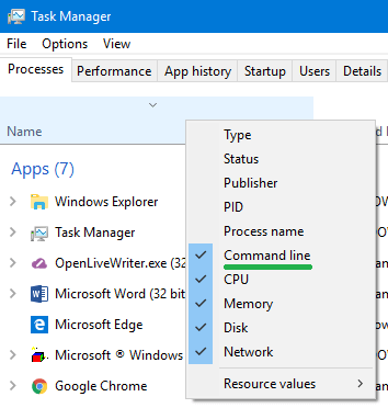

You can enable the “Command line” column in task manager to see what the python process is running.

No I really can’t. This is windows 8.1. Through other means it says PlexScriptHost.exe with a description of “Python” using 25%. When I built this server I had problems with windows 10 running plex. This was several years ago and I never went back to update the server to Win 10.

You can definitely enable the “Command line” column on Windows 8.1…
