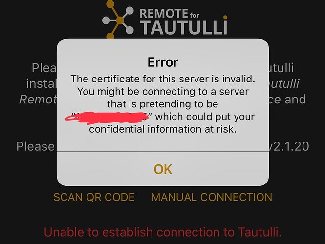

Apologies if this is not the right thread or if this has been asked before, but I have scoured the internet for hours trying to find the answer and have not come up with anything that has the correct info! .
I’ve been using this app for sometime with http, but want to start using https. I enabled it in the settings and am using the self-assigned cert. The issue I’m having is that when I try to connect to the service using the app on my iPhone i get an error message stating that the app cannot connect because the cert is invalid. How do I get past that error?
That’s not a Tautulli question - you need to search internet for IOS “allow self-signed certificates for IOS (or your browser version/Safari/Firefox/Chrome for IOS)”
Tip #1 and #2 of this one MIGHT help you, but, yeah, little to do with Tautulli - could happen with any web server you use self-signed certificates.

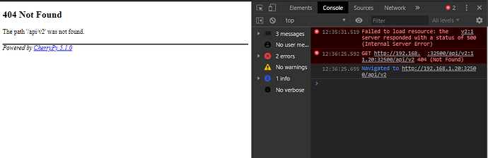

@SwiftPanda16 do you know why I’m having this issue?
I Can’t access http://192.168.1.20:32500/plexpy/api/v2 :
http://192.168.1.20:32500/api/v2 :
Fixed.
That did it. Thanks Sir.
