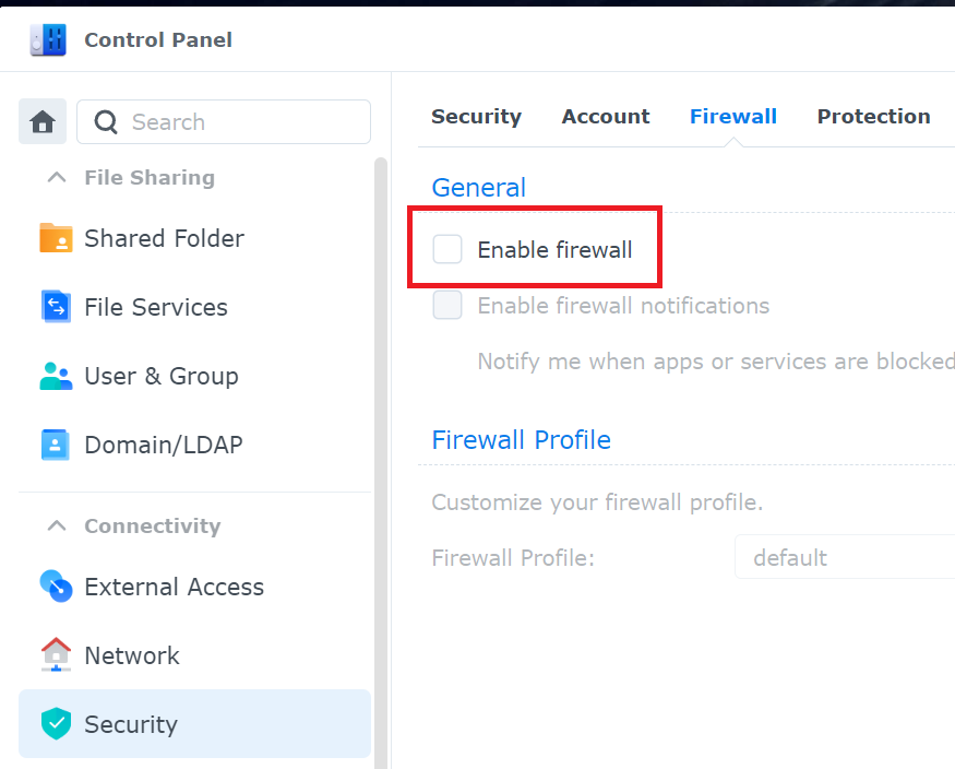

Enable SSH on the NAS.
You may also need to disable the NAS’ firewall.
I enabled SSH and the NAS firewall was not enabled anyway.

EDIT: Here’s the SSH and Firewall settings on my Synology:
Thank you for that. My DSM settings correspond with yours.
