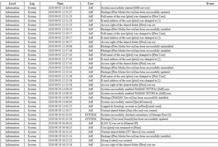

today i updated the Plex application and when i went to run it, i received the message “failed to run the package service”. i have tried to uninstall PMS and re-install with no luck. how can I get plex running again. DS920+

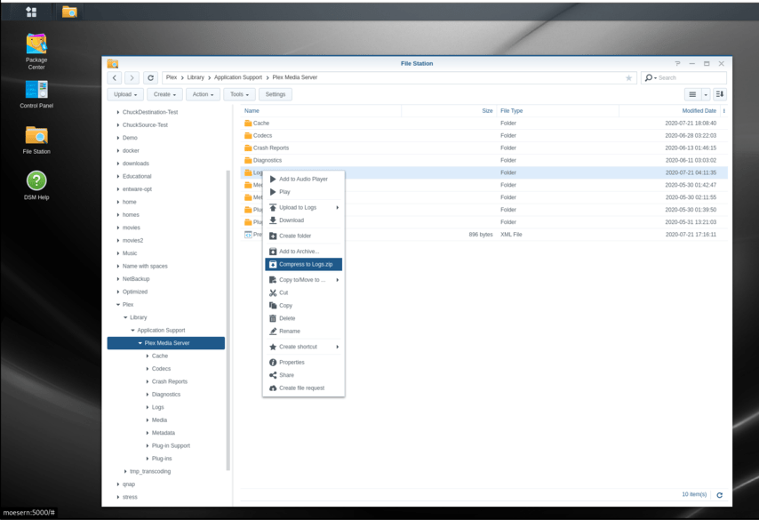

Please go to the Logs directory,
Right-Click Logs then Compress to Logs.zip
download and attach that ZIP file please.
I think this is the log directory. sorry, I a new to NAS and relatively new to Plex I hope this is it.
Sorry, that’s not what I was hoping for.
File Station -> Plex share -> Library - Application Support - Plex Media Server -> Logs
Make a ZIP of this folder please.
Thank you for the path steps. I found “logs” and right click on the folder and download. It creates a zip file but it error out when i try to upload it. The file size is 119,500KB. Maybe this is too large?
That’s the wrong file then.. your logs should be 25-50 MB maximum before compressing.
It seems like you compressed the entire Plex share.

also here is a screen shot of my directory file. My plex data (movies etc) are stored in the folder above Plex (Movies, Music, Pictures) Not sure if this makes a difference
