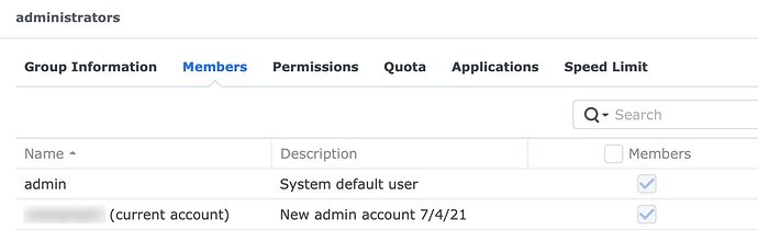

That account appears too be a member of the admin group, as you say. I will go back over your instructions and see what happens. I have noticed an odd thing, in that if I am unable to play a movie with the Amazon Fire Plex app (which is usually the case, especially early in the day), I close it and start up the Panasonic Plex app where I can play the file fine. If I then return to the Amazon Fire version,I am now able to play the movie.
