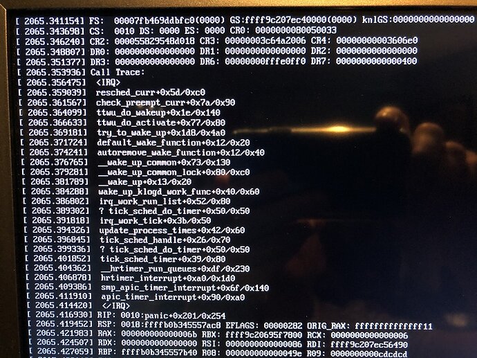

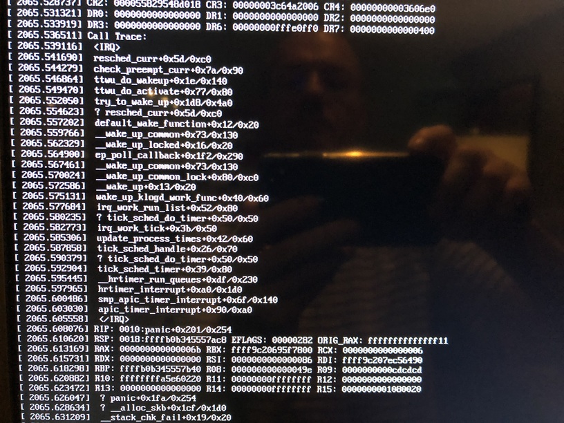

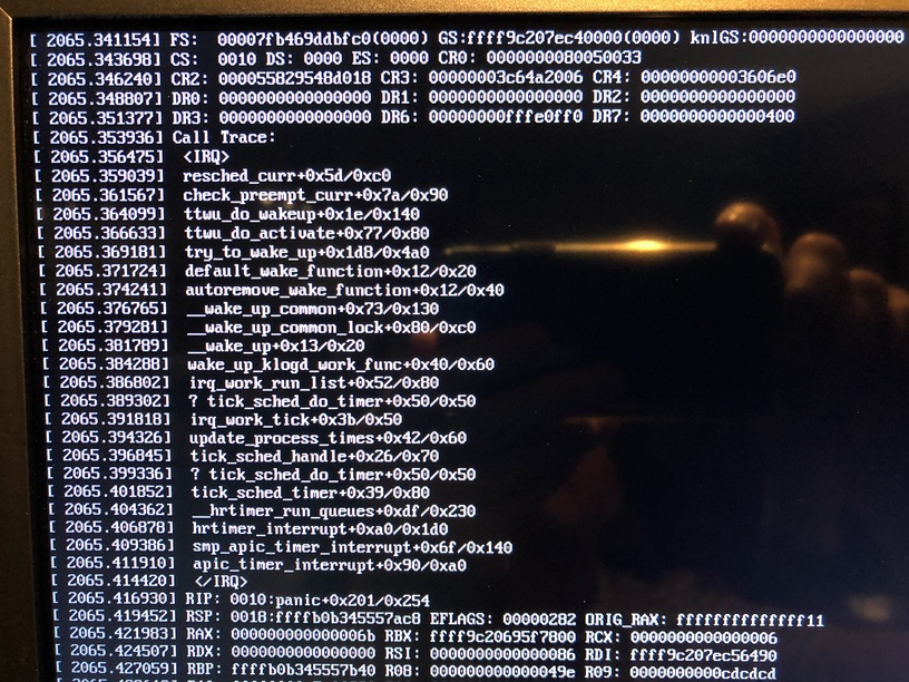

Unlike the first time, I am not able to ssh to or even ping the server anymore.
server console (apologies for poor quality images)
Is that CPU overheating ?
It looks like either the ethernet adapter driver or the i915.
May I see the full logs ZIP please, preferably a set where this is captured?
Also, may I see the journal kernel logs for the event?
This looks very much like a hardware issue but also could be a bad kernel issue.
