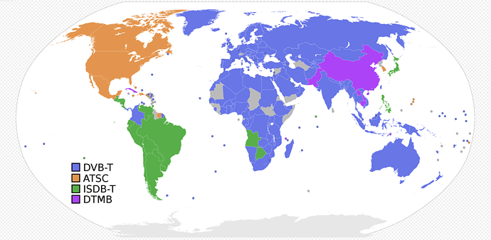

As Plex is a Global business and supported globally, I don’t see an issue with Digital being mentioned. As this map below shows that most of the world are digital except for the US
“ATSC” is ambiguous. This standards body has released specifications for both analog and digital, terrestrial TV.

LIES. The rest of the world is INSIDE the United States!
This map confuses and scares me. Why is the USA so small?
You expect me to believe Brazil and Australia are the same size!?!
