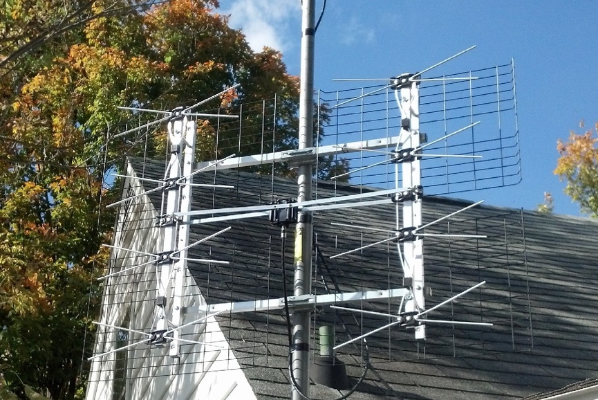

I have the one below (DB8) aimed directly at a (mostly) destroyed (lightning, 5 years ago) PBS translator 3 miles from here, broadcasting at a blistering 14 watts - to get 75% with:
I have a bunch of antennae - I used to live nearer civilization - and it took the biggest gun I had. If there was another one off the backside - I’d have something aimed at it.

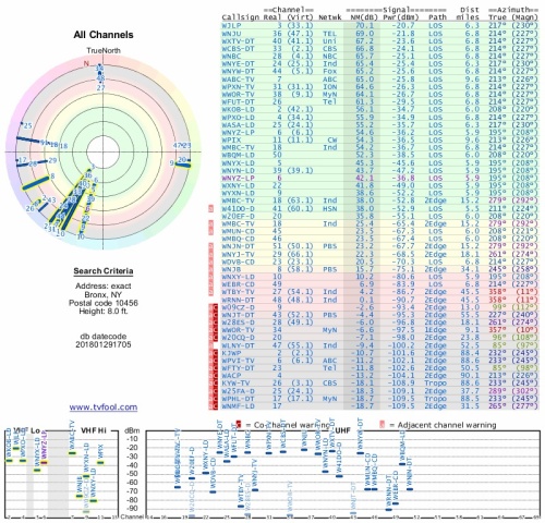

If you care to share that “Fool” report image, and mention the antenna you have now, we can see what you have going on over there.

I don’t understand much about the mechanics of antennas, but from what it looks like here, I’m better off with an “outdoor” antenna, which is not practical or not likely I’ll get. I wish there was a away that PLEX can work with PLUTO. That would solve a LOT… LOL
image host
You have an attic or some other space to hide one? Mine is in the attic and works ok, sometimes have some signal fade but where you’re at the signal should be ok I’m hoping for what channels you’d want. Looks like vast majority are to the south west.
You are now the envy of every broadcast TV refugee on the planet.
With that RCA antenna above you could saturate your viewing experience with more channels than you can watch. Put that thing in a closet, or attic, or tucked away somewhere outside.
ALL your ‘possibles’ are line of sight and under 10 miles away. If the exterior covering of your abode isn’t metal, or the roof isn’t metal, you should be good to go.
