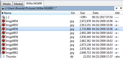

Looking at Plex Media Scanner Analysis.log file and I saw this.
Doing expensive tags write for ‘IMGP0855’ because something changed.
That file has been static since 2009, it sure isn’t changing.
Why is Plex scouring the entire drive looking for objects?
It is not in the Media directory structure.
