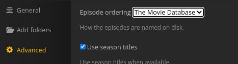

All you can control is the episode ordering based on how you have named your media on disk. Its in the advanced settings of your library or the show level. See screenshot below…
Screenshot from 2022-05-13 14-38-18
