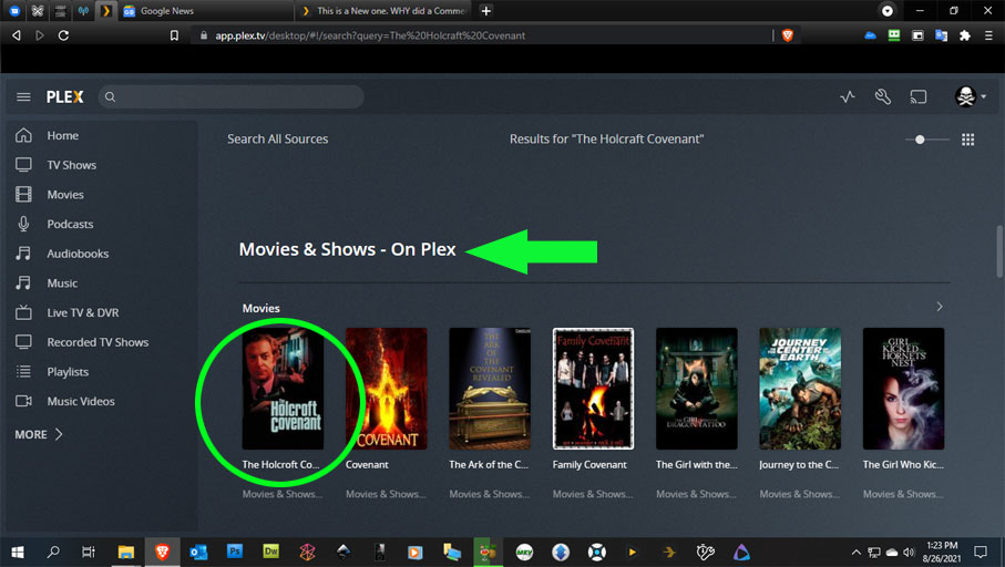

Yes. https://support.plex.tv/articles/video-on-demand-overview/ That guide is for the free movies and Shows. You do the same for any service you don’t want enabled.
Seems you where watching the Movies & Shows On Plex Version
Since I don’t own that movie and a search found it in their services section.

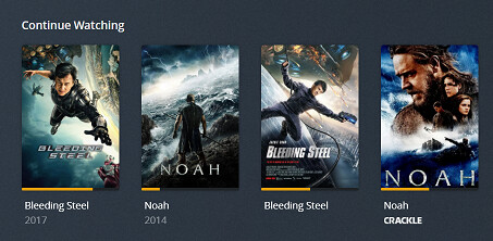

Movies from Plex and movies from your own library should not get mixed up. Mine on the left, from Plex on the right. You can see they have different play progress so not tracked together.
(I agree; I haven’t been able to duplicate this. I should have said local movies have the same ID regardless of Library, and that it was a total random unfounded conjecture that maybe something similar was going on. I see the same thing you show in your screenshot.)
Watch History is even stored differently for local vs. Plex movies! IDK how that could get mixed up.
