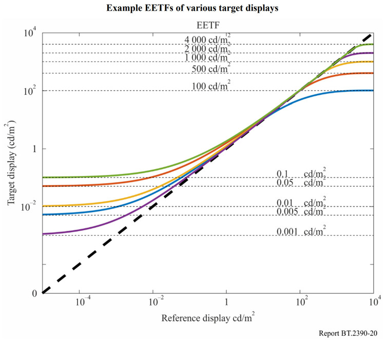

Yes. I believe Jellyfin (like Plex) is simply using a preset EETF (electrical-electrical transfer function) as described in the ITU BT.2390 reference doc listed below instead of utilizing the L1/L2/L8 metadata to dynamically tone map per Dolby’s spec.
5.4 Display mapping
The PQ HDR system generates content that is optimum for viewing on a reference monitor in a reference viewing environment. The reference monitor would ideally be capable of accurately rendering black levels down to or below 0.005 cd/m2, and highlights up to 10 000 cd/m2. Also, the ideal monitor would be capable of showing the entire colour gamut within the BT.2020 triangle. The viewing environment would ideally be dimly lit, with the area surrounding the monitor being a neutral grey (6 500 degree Kelvin) at a brightness of 5 cd/m2. However, content often must be viewed or produced in environments brighter than the reference condition, and on monitors that cannot display the deepest blacks or brightest highlights that the PQ signal can convey. In these cases, the display characteristic needs to be changed in a process often referred to as display mapping (DM).
5.4.1 Mapping to display with limited brightness range
High dynamic range content may be viewed on displays that have less dynamic range than the reference display used to master the content. In order to view HDR content on displays with a lower dynamic range, display mapping should be performed. This can take the form of an EETF (electrical-electrical transfer function) in the display. This function provides a toe and knee to gracefully roll off the highlights and shadows providing a balance between preserving the artistic intent and maintaining details. Figure 18 is an example EETF mapping from the full 0 – 10 000 cd/m2 dynamic range to a target display capable of 0.01 – 1 000 cd/m2. The EETF may be introduced into the PQ signal; the plots show the effect of the mapping, i.e. how the intended light is changed into actual displayed light. In practice the mapping is done on the PQ signal.
Calculating the EETF
The central region of the tone mapping curve is defined as a 1:1 mapping. A ‘knee’ roll off may be calculated using a hermite spline to create a mapping that will reduce the luminance range to the capability of the display. The black level lift is controlled by an offset, b, which would be determined by a PLUGE adjustment. The difference between this proposal and the black level adjustment per Recommendation ITU-R BT.1886 is the addition of a tapering factor (1 – E2)^4. Without such a tapering factor, a constant offset throughout the entire signal range has the effect of increasing the brightness at the high end. With Recommendation ITU-R BT.1886 this effect was limited and not problematic due to the large number of code values at the high end of the gamma curve. The perceptual uniformity of the PQ EOTF causes this effect to be unacceptable. The tapering function allows fine-tuning the lift without a significant impact on mid-tones or highlights.
Practical application
The sample curves shown in Fig. 20 are designed for tone mapping to display black level up to 0.1 cd/m2 and display white level as low as 100 cd/m2.
