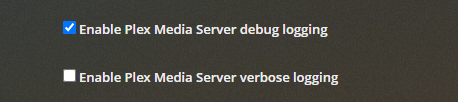

Please turn on debug logging for your server. Recreate the issue and provide new logs.

That’s not correct. You provided the debug log for Plex Web, which is not what I need.
To be clear, I mean this setting under the general tab for your server.
