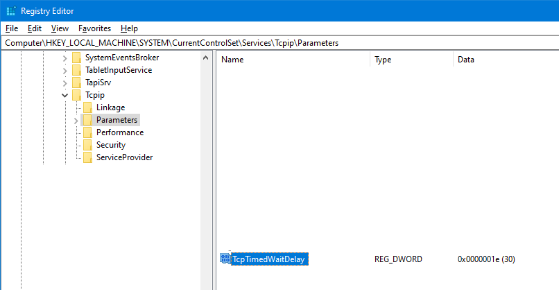

It this the correct way to construct the reg entry for reducing the time wait?
Yes - that is correct. Reduce it to decimal value 30

For doubling the size of the tcp dynamic ports - set it to start at 32678 with size of 32678
NetSh INT IPV4 SET DynamicPort TCP Start=32768 num=32768
NetSh INT IPV6 SET DynamicPort TCP Start=32768 num=32768
Making these changes together with the curl change would probably resolve the issue for large TV libraries until there is a new in-line scanner. The changes on their own without the curl fix would also help
