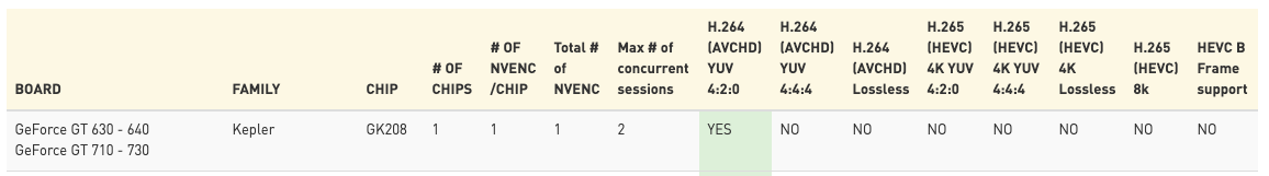

nvidia cards are limited by driver to only allow a certain number of NVENC sessions at the same time… You card may be limited to a single one.
It does show on the Plex interface that multiple streams have (hw) indicator besides them to indicate that hardware acceleration is being used. How can I tell how many sessions it can support?
As seen in: https://developer.nvidia.com/video-encode-decode-gpu-support-matrix

The concept (of adding a GPU to support multiple transcoding) does not look viable then as most of the chips on that link only support 1. The ones that do 3 are over $3000.

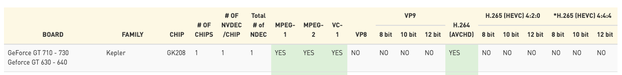

You are misunderstanding the chart a little bit. For decoding, there is only one chip but it handles several sessions. Encoding is session limited to 2. Your real problem was the CPU had to keep in audio in sync with the video (probably burning in subtitles) and that took 100%.
