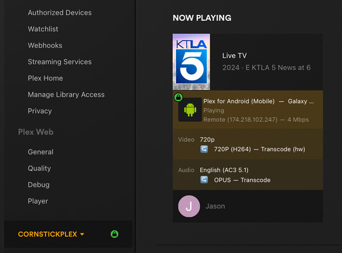

Okay. I’ve narrowed it down to an issue with the Roku client app. See the attached screenshots and logs.

So to review what the screenshots are confirming is that when I use the Android mobile client everything appears to function as they should. However when I use the Roku client a couple different issues appear. One being that the server uses software instead of hardware for transcoding and the other is the playback is a mess. It’ll play a few seconds and then start over at the beginning of the stream again. Sometimes repeating this twice before smoothing out.
