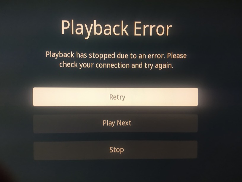

I didn’t stopped. It ended with a playback error like this one.
I just exited.
This time around I’ve disabled all subtitles and used three different files. Being the last one. A PBS Special in HEVC 8 bit.
I only tested on the Roku 3. You didn’t mentioned the Fire TV Stick
I can tell you that all attempts ended with same behavior. It loaded until 33%. Then ended with a playback error message.

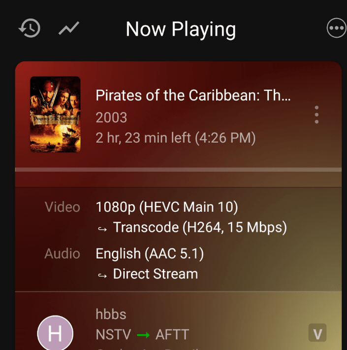

When I try to play something that needs transcoding the Hardware icon appears on Plex Dash.
But it never really starts out. The curious thing if that when I do that on the Fire TV Stick (2018) model that doesn’t support HEVC 10 bit it goes straight to software decoding (and a lot of buffering pauses)

Looks like it first tried to direct play the file and couldn’t, then tried a transcode. The Shield did initiate hw transcoding, but the playback failed so PMS went to cpu transcoding.
With the issue on both Roku and the Fire TV, it does point to the server. Although, I’m not experiencing this with my Shield. I’ll do more digging to see what’s going on.
