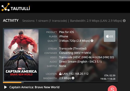

In the attachments are screenshots from PMS and Tautulli when I tried to transcode a 4K movie to “1080p HD (High)” on my iPhone, which estimates “20 Mbps (About 9 GB per hour)”. You’ll see that the transcode is using HW (correct) but the output is in “SD” and 3 Mbps 720p (incorrect).
I have tried toggling “Enable HEVC video Encoding”, but it has no effect other than to change the transcode output from H264 to HEVC (but still “SD”). Interestingly, Tautulli reports “Transcode (Speed: 17.2)” instead of “Transcode (Throttled)” when I disable HEVC video encoding. But, regardless, the output is always 720p.
The “Transcode (Throttled)” in my screenshot bothers me, but I have no idea why that would be the case… Perhaps that’s a clue?

The screenshots suggest that there is a bitrate limit of 3 Mbps in effect for the transcoding. You cannot sensibly cram 1080p resolution into a 3mbps stream, particularly with hardware transcoding which is not optimized for efficiency.

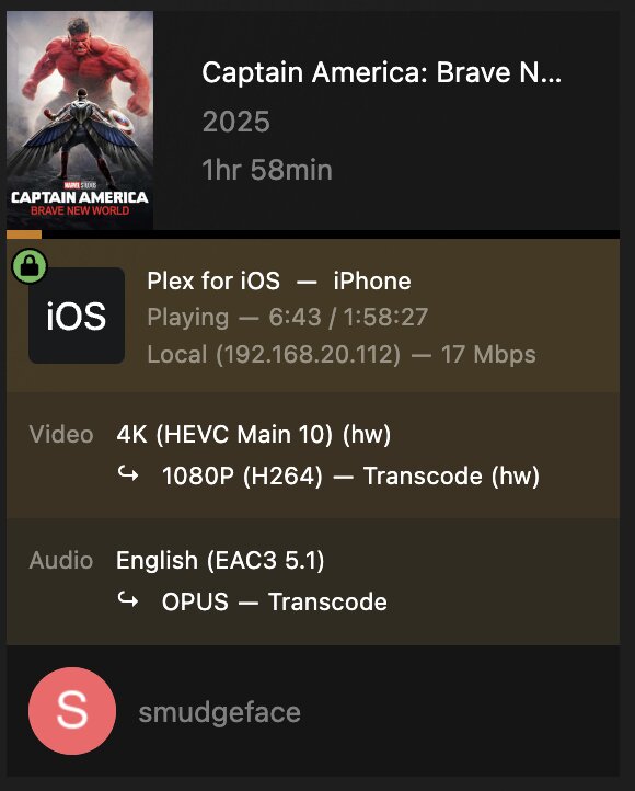

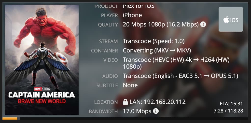

OK, so I installed a second container instance with fresh config, pointed it to the same library folders, and pointed my clients to the new server. I made no changes to my client configuration and ran the new server with no changes to default settings.
Again, in my iOS client, from the triple-dot menu at the bottom right (while viewing a video) I chose “Quality > 1080p HD (High)”. This is what I see in Plex dashboard and Tautulli
In other words, it works great. So, there’s hope.
