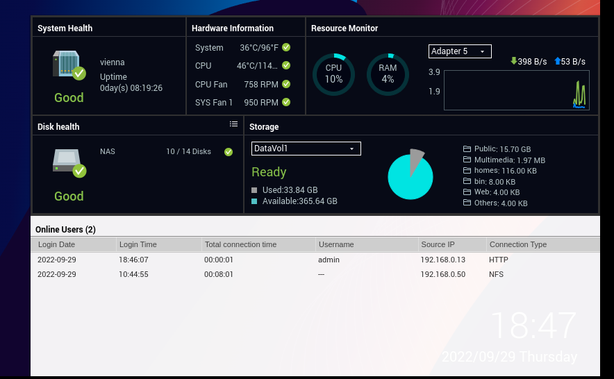

Testing the speed to the NAS with a file copy, looks ok :slight_smile:

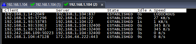

tcptrack
I tried copying a 4k movie to the local SSD just in case and that had the same problem.
