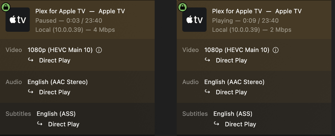

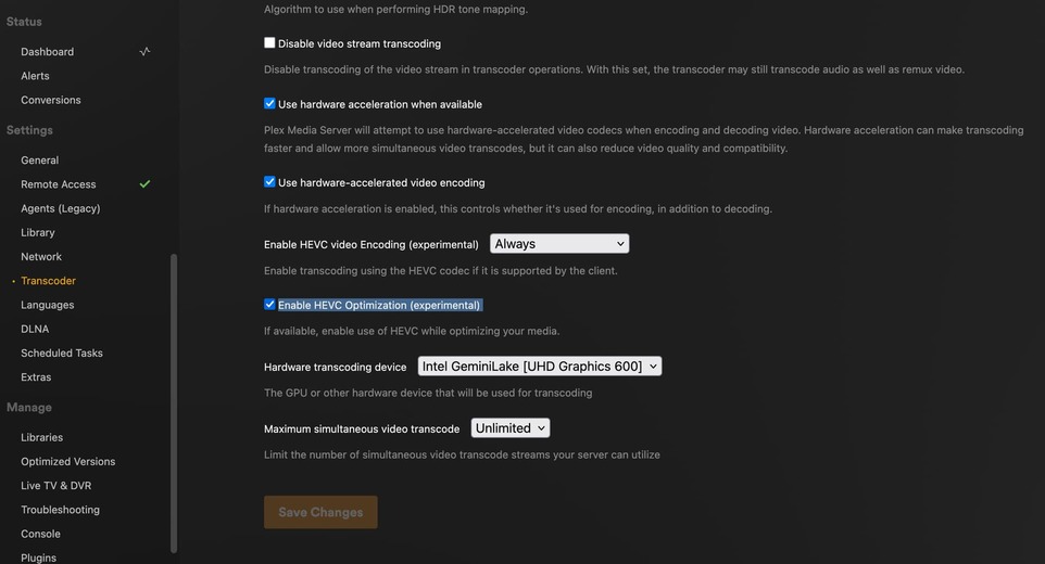

So I remembered something ChuckPa had said about disabling Enable HEVC Optimization (experimental) for my gemini lake gpu. I disabled it and tried again and it stopped transcoding. I re-enabled it and it still no longer transcodes. I watched the same episode as before. 8.45 on the left, 2025.15.0 on the right.
I don’t seem to have that setting (or can’t find it?)
It’s in your server transcoder setting, Server Name -> Settings -> Transcoder
I don’t have that option either. thats dependent on what intel chip you have.
Sorry, but maybe it will help the developers figure out why.
That option only shows up if you have the Enable HEVC video Encoding (experimental) option enabled. I enabled that and tested with the other option enabled and disabled and it still didn’t seem to make difference for me either way. Note that I was testing with an IPad though, not Apple TV (I’ve got that as well but not using HomePods with it).
