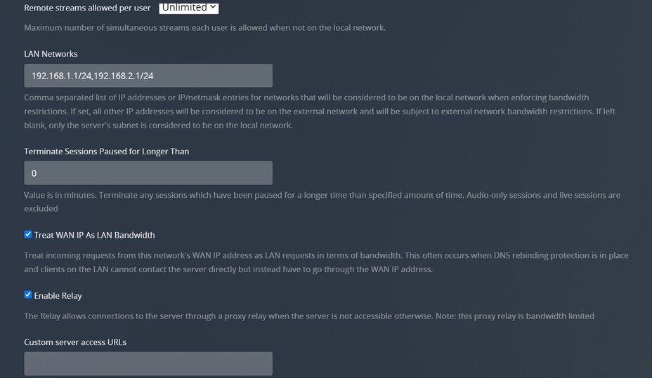

However if I change either the pc or the tv’s wifi connection so they don’t match Plex assumes it is a remote connection.
I read that if you put the ip range in the Network settings Plex server will consider that range as local.
It does not seem to work when I try this.
Network one is 192.168.1.1 Running Wireguard VPN
Network two is 192.168.2.1 Running OpenVPN Vpn
I used cidr to create the IP/netmask entries as shown in the image I enclosed.
Is there another setting I am missing as no matter what I have tried it is still assuming it’s remote rather than local
