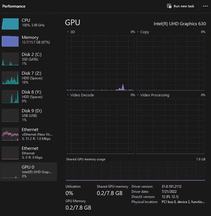

With the recent addition of HEVC transcoding I decided to see if transcoding my 4k disc rips was now more feasible with my system. I’m running into an issue though. I can’t get hardware transcoding to kick in no matter what type of file I am playing. I am relying on the integrated iGPU on my processor. UHD Graphics 630. I have tried turning the new HEVC mode on and off and it is not making a difference. I’ve also tried multiple players and am getting the same results.
To simplify it I decided to focus on a 1080p disc rip. I am getting very high CPU utilization and no usage on the GPU. I don’t use transcoding often, but I do recall hardware transcoding working previously. Any ideas what this could be? I have logs. Here is the portion I think may be relevant. If I need to post the entire log I can.

@Rick_Williams Do you see any difference in behavior if you select your iGPU instead of leaving the hardware transcoding device set to Auto?
I do not see a difference.
