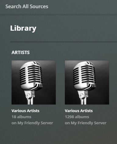

The Problem did came back:
You see the artist Alain Goraguer with about 638 albums.
Those are, VA albums, no albums by Alain Goraguer.
Explorer shows 6 folders aka 6 albums:
Various artists are double (and I guess, other artists have doublettes too, because Plex doubled a lot of artists the previous attempts when indexing the music)

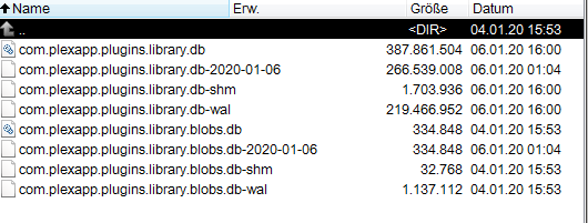

This is the Database directory:

The size of the WAL (pending transaction) file is alarming to me.
It should be near zero.
Given the gross misclassification of the albums, there must be something else going on.
my WAL file is almost always increasing to the same size (or there about) as the db file, until pms is restarted, at which point the WAL will shrink, then expand over time, until the next restart.
That’s how it should be. When PMS is stopped, all pending transactions in the WAL file should be committed as the SQLite3 session ends.
I’m confused, you said the WAL should be near zero.
I am stating that my WAL is never near zero except at PMS restart.
My DB is in excess of 1 GB, as well as the WAL file.
This has been the behavior for as long as I can remember.
if this is not normal (per your WAL should be near zero), then I am simply saying that the behavior is not only with FlexiPlexi system.
Correct, at PMS start, the WAL should be at or near zero.

While PMS is running, the WAL file grows to accept the in-process changes.
When PMS shuts down, SQLite3 commits these to the DB.

Is the screenshot above, showing 219 MB WAL, with PMS running or stopped ?
Ah, well that is not mine, and it does not appear to be stated if that is running or not.
I assumed running.
