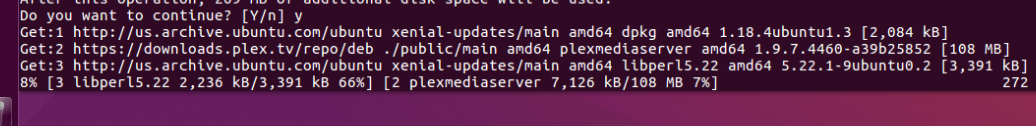

ChuckPa
November 30, 2017, 2:27pm
18
Check your repo definition statement again as I am still getting.
ChuckPa
November 30, 2017, 3:41pm
19
As additional information, there is no InRelease reference
