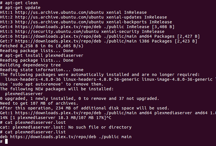

Hopefully I understood the question. Let me know if I need to provide more details.
This shouldn’t be the URL to use.
E: Failed to fetch https://downloads.plex.tv/repo/deb/dists/./public/InRelease 403 Forbidden [IP: 104.20.6.9 443]
E: Some index files failed to download. They have been ignored, or old ones used instead.
Change InRelease to main in the sources file :slight_smile:

So the InRelease is a step it takes for all repositories, but there is nothing to change on my end.
Also re-pasting above, but here’s my Plex repo config:
$ cat /etc/apt/sources.list.d/plexmediaserver.list
deb https://downloads.plex.tv/repo/deb ./public main
We both see the definitions are right.
