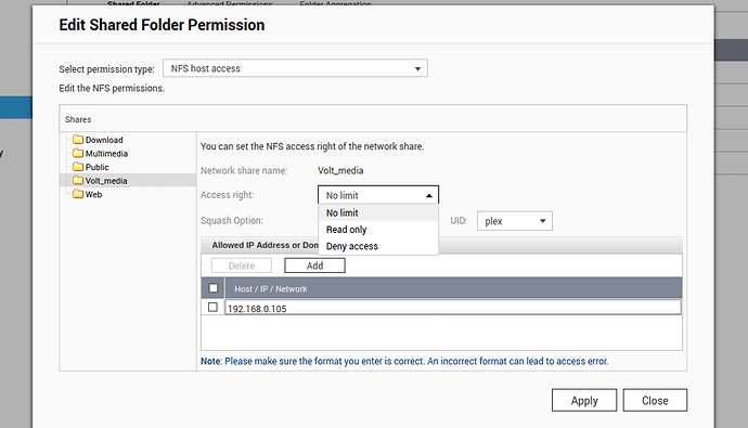

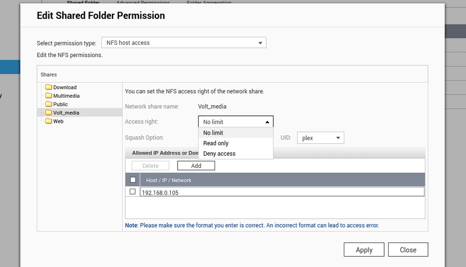

Maybe here is something wrong in NAS settings :

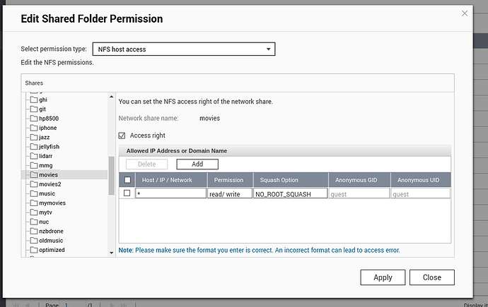

What you show is not right.
The * is default, The only field you want to change is the read-only to be read-write.
after making that change, unmount and remount the NFS share then cd out and back in.

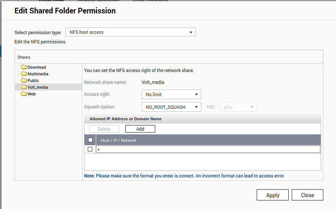

I don’t have option like you:
I set no limit so it should be like read-write. I don’t have any idea what should be other “squash”, UID and so on…
