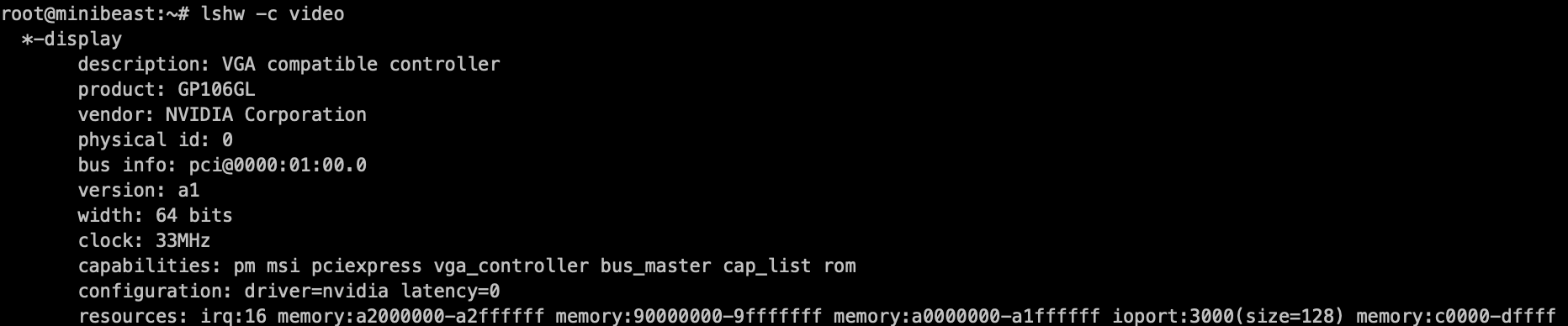

nvidia-smi 390.87 / driver 410.78
also tried driver 390.87
A brand new Ubuntu 18.04 server (headless) build with a nvidia p2000, i7-8700 CPU was transcoding with ease yesterday. Today not one HW transcoding can be initiated and the cpu is saturated with 8-9 streams.

Linux minibeast 4.15.0-39-generic #42-Ubuntu SMP Tue Oct 23 15:48:01 UTC 2018 x86_64 x86_64 x86_64 GNU/Linux
The only changes that occurred within the last 24hrs was me plugging in a 4k dummy plug instead of monitor and a reboot. I also enabled liveTV via my hd homerun.
I have since swapped back to a 4k monitor and the problem exists.
root@minibeast:~# ls -ahl /dev/dri
