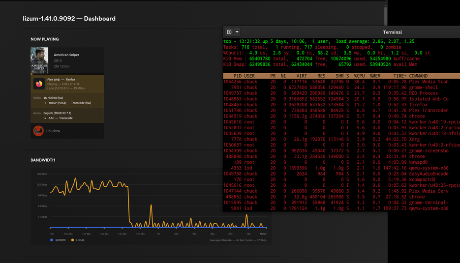

Ubuntu 22.04 and Ubuntu 24.04 HW transcoding
Cannot replicate transcoding problems with Ubuntu 22.04 & PMS build 9092
Please attach DEBUG logs ZIP file which captures the failure.
