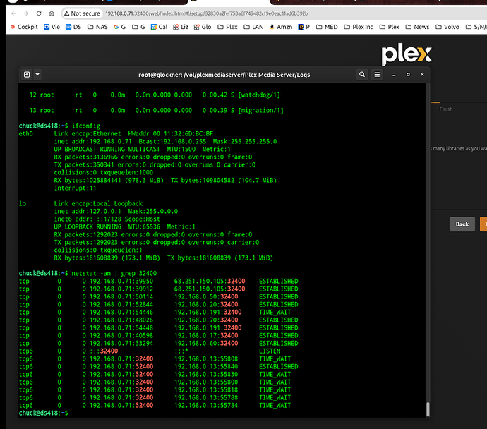

I took one of my NAS boxes, (IPv4-only) and did a “burn down & restart” test
I can’t repro what you had happen so I’m anxious to see your logs.
One thing I see, the NAS has IPv6 loopback. I can’t turn that off
