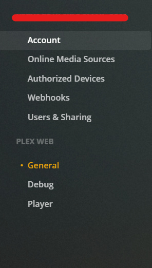

I attempted to ssh tunnel port 32401 and managed to connect to the server, but after logging in no server configuration was available in the settings. The installation article states ssh tunneling should allow for server configuration.

Well, that’s the issue though. The server settings page is missing when I connect to the web client through the SSH Tunnel so I got the logs that I could from the Logs directory and client Debug section.
