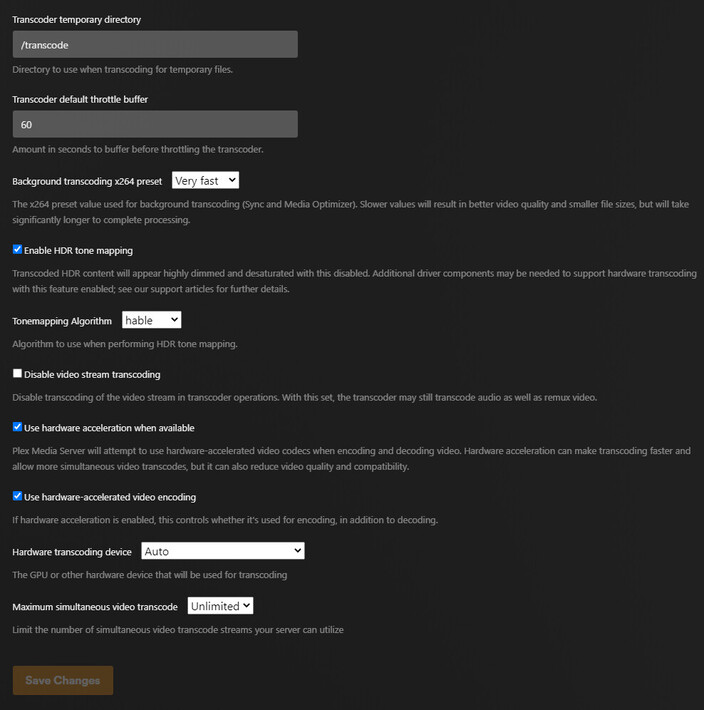

Get into Plex/web
Settings - [server] - Transcoding - Show Advanced.
This is my N100 transcoder settings
I do not know why your machine isn’t behaving but I will find out and solve it
Here are my plex ( 1.41.0.8930) settings:
