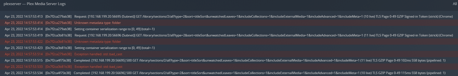

I updated my ubuntu server and plex install last night. When I try to go to one of my libraries, doesn’t matter which player, it fails to load.
In the console, I see two errors, that each happen twice.
Unknown metadata type: folder
Exception handled: std::bad_cast

The Console errors are meaningless.
What’s really needed are the PMS log files
