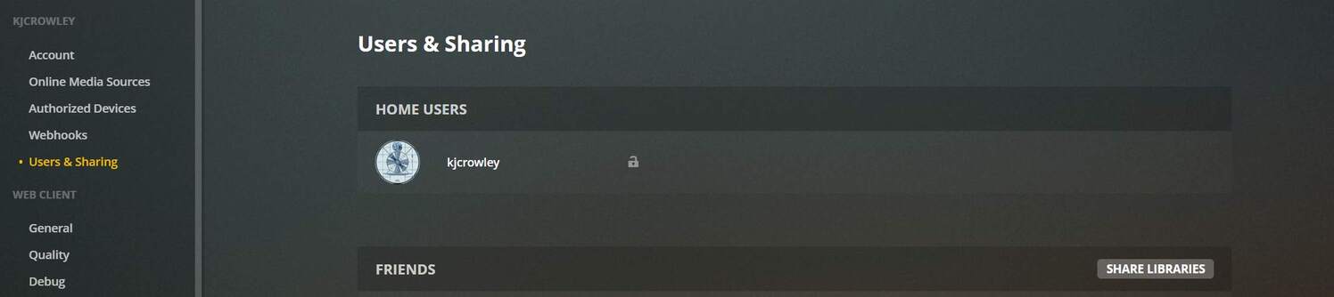

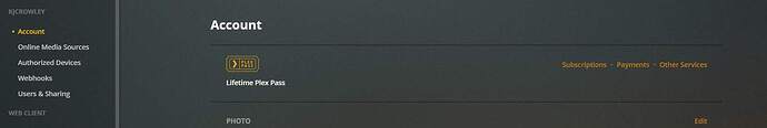

I am trying to add a home user but the button to add a home user, managed user or guest is missing. I do have plex pass. Any help appreciated!
The one account showing is not identified as the Admin account. I don’t know why that is, but that probably explains why the ‘Invite’ buttons are missing.
I have another account, but for various reasons I could not get the plex pass on that account, and that account does say Admin. How do I transfer admin rights to the account with the plex pass?
