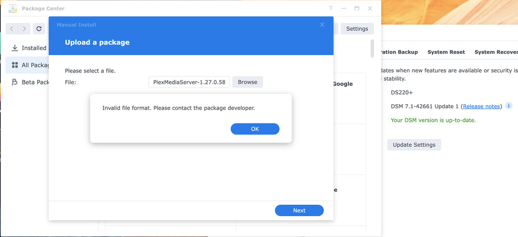

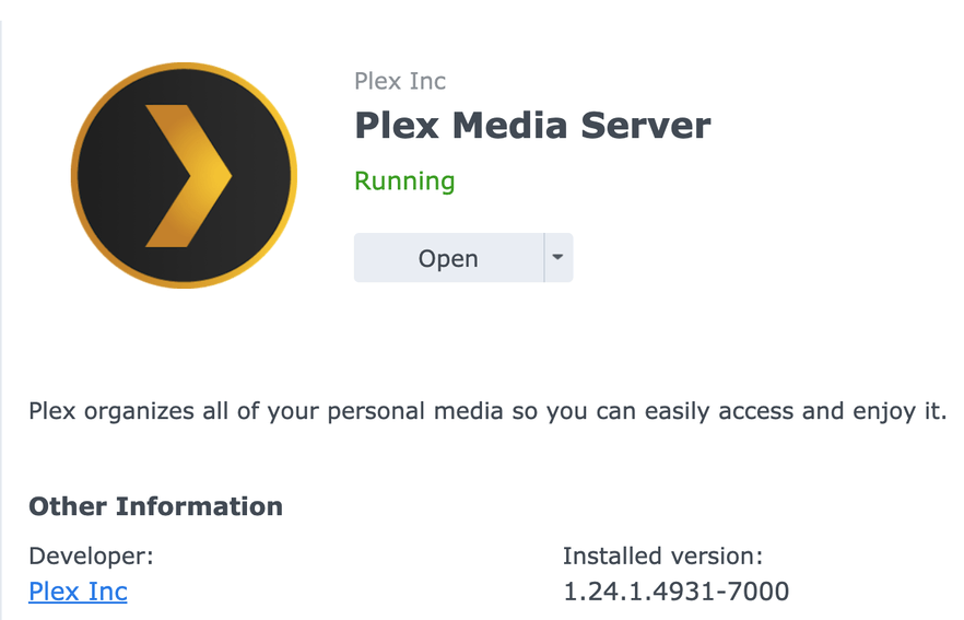

I currently have PMS 1.24.1.4931 running in DSM 7.1-42661 Update 1 on a Synology DS220+. I have tried multiple times to manually install an updated version of PMS and every time I get “Invalid file format. Please contact the package developer.” I am downloading the DSM 7 (Intel 64-bit) version of the packages from https://www.plex.tv/media-server-downloads. I have restarted my NAS multiple times and have also shut it down completely but neither of these simple solutions have made any difference.
I’ve tried the following packages and all have failed with the same error:
PlexMediaServer-1.27.0.5849-99e933842-x86_64_DSM7.spk
PlexMediaServer-1.26.2.5797-5bd057d2b-x86_64_DSM7.spk
PlexMediaServer-1.25.9.5721-965587f64-x86_64_DSM7.spk
Anyone have any other ideas of what I can try? Thanks in advance.

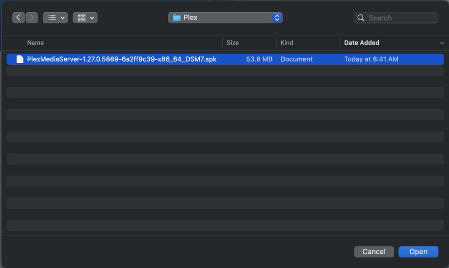

I’m not sure if this helps but the file size of my PlexMediaServer-1.27.0.5889-6a2ff9c39-x86_64_DSM7.spk is 109.9 MB NOT 53.8 MB as in your screenshot.
@mstandiford
The file length you show is not correct.
The problem you’re facing is how you’re downloading from Plex.tv/downloads.
The browser is not downloading correctly.
