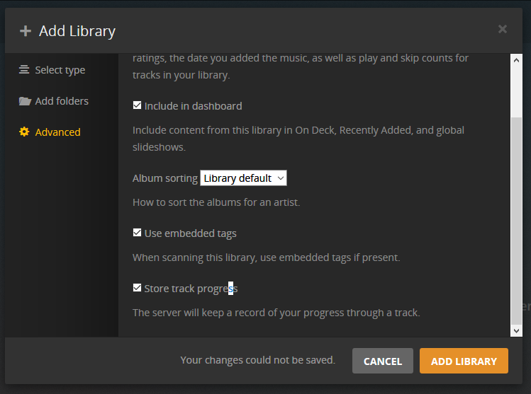

I tried tweaking my library scanning agents, but was met with the error, “Your changes could not be saved.”

Now, there are no libraries in PMS and I’m not able to create any libraries. I’m still getting the error, “Your changes could not be saved.”

“Sep 05, 2018 19:59:31.313 [9520] ERROR - Library: Couldn’t create section: ‘agent’ is missing or invalid”.

I’ve also noticed that when creating the library the option to select the library’s language is not populated.
