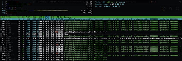

… and a screenshot from htop showing something like 13 “Plex Transcoder” threads all churning away at the same media file (which I could see by scrolling to the right, couldn’t capture it in the screenshot):
I’ve never seen more “Plex Transcoder” threads in htop which makes me think that the setting to only transcode one file at a time was being respected. However clicking on the “Activity” icon (with the orange circle swooping around it) always shows a list of all the files currently being processed (currently one transcode and one download (same episode)).

That setting is for streaming. Downloads is different. It can do 2 transcodes at a time. Transcoding is a multi-thread process so seeing multiple threads is expected even with just 1 file being transcoded. The main difference between streaming and downloading is that downloading has a lower priority. My guess is that Downloads thinks your computer is busy so it’s working slower than expected. I haven’t looked at your new logs yet. I’ll get back to you after I do.
