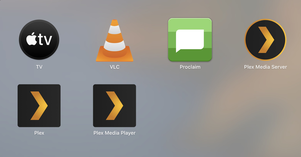

These are currently the three plex apps that I have. It is the one that says just “Plex” that I should delete and reinstall, right?
Should that be deleted and reinstalled before or after I clean out the folder/folders that you suggested above in your last message to me? Thank you.
I was not talking about uninstalling the app.
It was simply purging all its application data - after securing your completed downloads.
